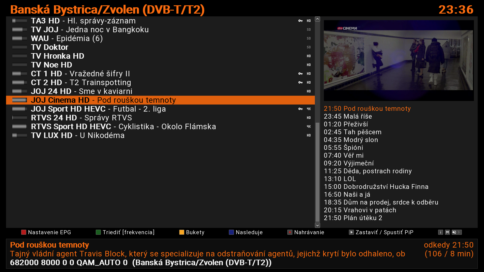

- Beiträge: 46
- Wohnort: Slovakia
- Box: MIO4K+ & HD51 & Solo4K
Is it possible to fix the display of satellite names?
Ist es möglich, die Anzeige von Satellitennamen zu korrigieren? Is it possible to fix the EPG?
Kann man das EPG reparieren?

- Beiträge: 46
- Wohnort: Slovakia
Fixed with encoding.conf (very old in image) but not know why ř show as ł (but Ř displays correctly)vanhofen hat geschrieben: ↑Fr 31. Mär 2023, 06:24 Here i need your help. I don't understand the slovak language. Please send a UTF-8 encoded mapping list like this:Code: Alles auswählen
# from = to  = ɨ
