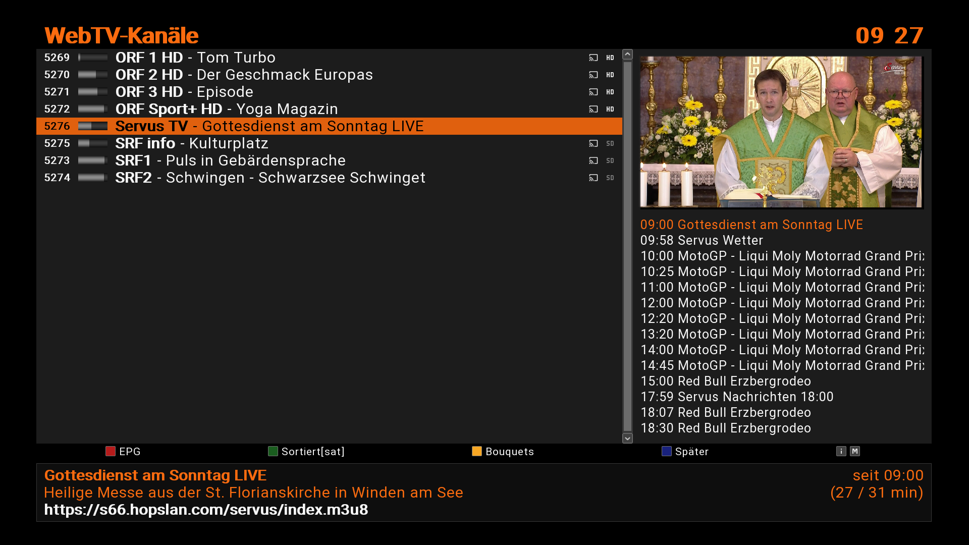

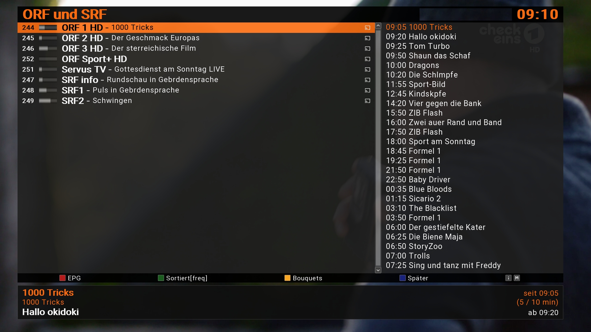

Aktuelle ORF und SRF Sender mit EPG.
<webtvs name="ORF und SRF">
  <webtv title="ORF 1 HD" xmltv="https://my.iptv.community/epg_temp_dl/output-epgs/austria.xml" epgmap="ORF1.at" url="https://s6.hopslan.com/orf11/index.m3u8" script="best_bitrate_m3u8.lua" description="Livestream" />
  <webtv title="ORF 2 HD" xmltv="https://my.iptv.community/epg_temp_dl/output-epgs/austria.xml" epgmap="ORF2.at" url="https://s6.hopslan.com/orf2/index.m3u8" description="Livestream" />
  <webtv title="ORF 3 HD" xmltv="https://my.iptv.community/epg_temp_dl/output-epgs/austria.xml" epgmap="ORF3.at" url="https://s6.hopslan.com/orf3/index.m3u8" description="Livestream" />
  <webtv title="ORF Sport+ HD" xmltv="https://my.iptv.community/epg_temp_dl/output-epgs/austria.xml" epgmap="ORFSport.at" url="http://212.18.115.193:3549/play/a05f/index.m3u8" description="Livestream" />
  <webtv title="SRF1" xmltv="https://my.iptv.community/epg_temp_dl/output-epgs/switzerland.xml" epgmap="SRF1.ch" url="https://s6.hopslan.com/srf1/index.m3u8" script="best_bitrate_m3u8.lua" description="Livestream" />
	<webtv title="SRF2" xmltv="https://my.iptv.community/epg_temp_dl/output-epgs/switzerland.xml" epgmap="SRF2.ch" url="https://s6.hopslan.com/srf2/index.m3u8" script="best_bitrate_m3u8.lua" description="Livestream" />
	<webtv title="SRF info" xmltv="https://my.iptv.community/epg_temp_dl/output-epgs/switzerland.xml" epgmap="SRFInfo.ch" url="https://s6.hopslan.com/srfinfo/index.m3u8" script="best_bitrate_m3u8.lua" description="Livestream" />
	<webtv title="Servus TV" xmltv="https://my.iptv.community/epg_temp_dl/output-epgs/switzerland.xml" epgmap="ServusTV.at" url="https://s66.hopslan.com/servus/index.m3u8" script="best_bitrate_m3u8.lua" description="Livestream" />
</webtvs>
Die Bildquali ist allerdings nicht die allerbeste.

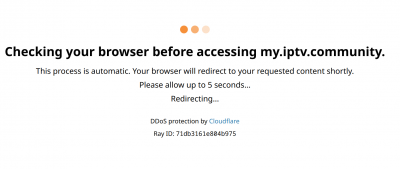

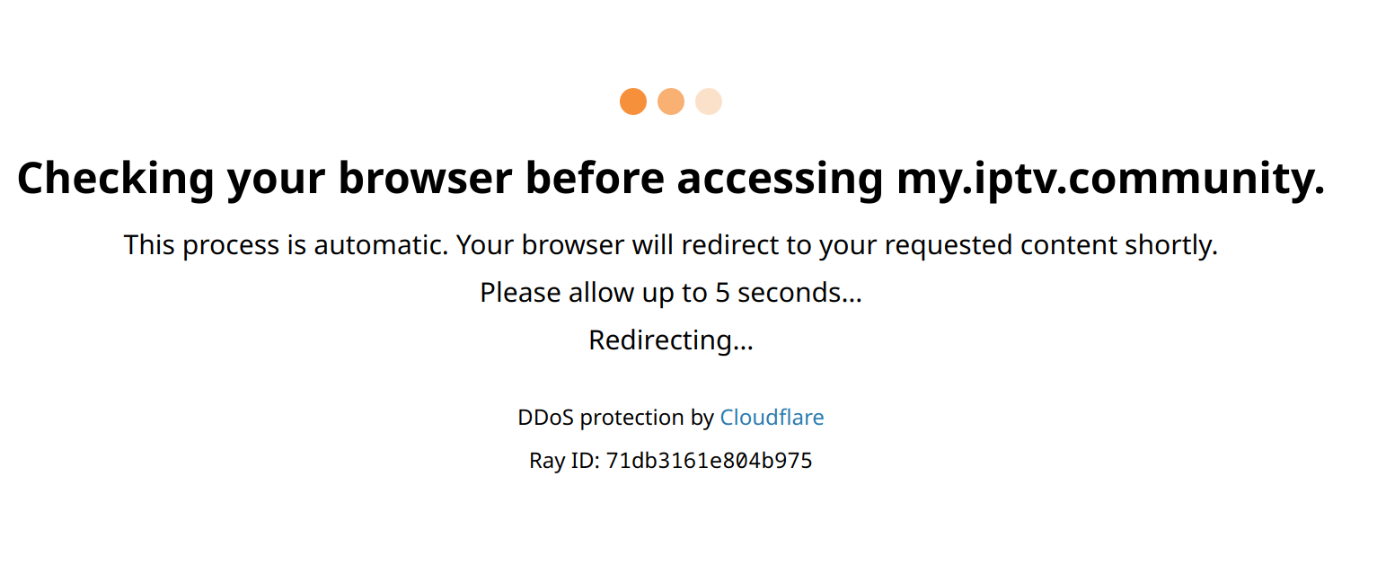

Re: ORF mit WebTV
da nutzt auch kein "epgid="
[jokel ~]# wget https://my.iptv.community/epg_temp_dl/o ... ustria.xml
--2022-06-19 12:53:43-- https://my.iptv.community/epg_temp_dl/o ... ustria.xml
Resolving my.iptv.community... 104.21.42.138, 172.67.206.29, 2606:4700:3037::6815:2a8a, ...
Connecting to my.iptv.community|104.21.42.138|:443... connected.
WARNING: cannot verify my.iptv.community's certificate, issued by ‘CN=Cloudflare Inc ECC CA-3,O=Cloudflare\\, Inc.,C=US’:
Unable to locally verify the issuer's authority.
HTTP request sent, awaiting response... 403 Forbidden
2022-06-19 12:53:43 ERROR 403: Forbidden.
