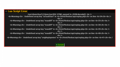

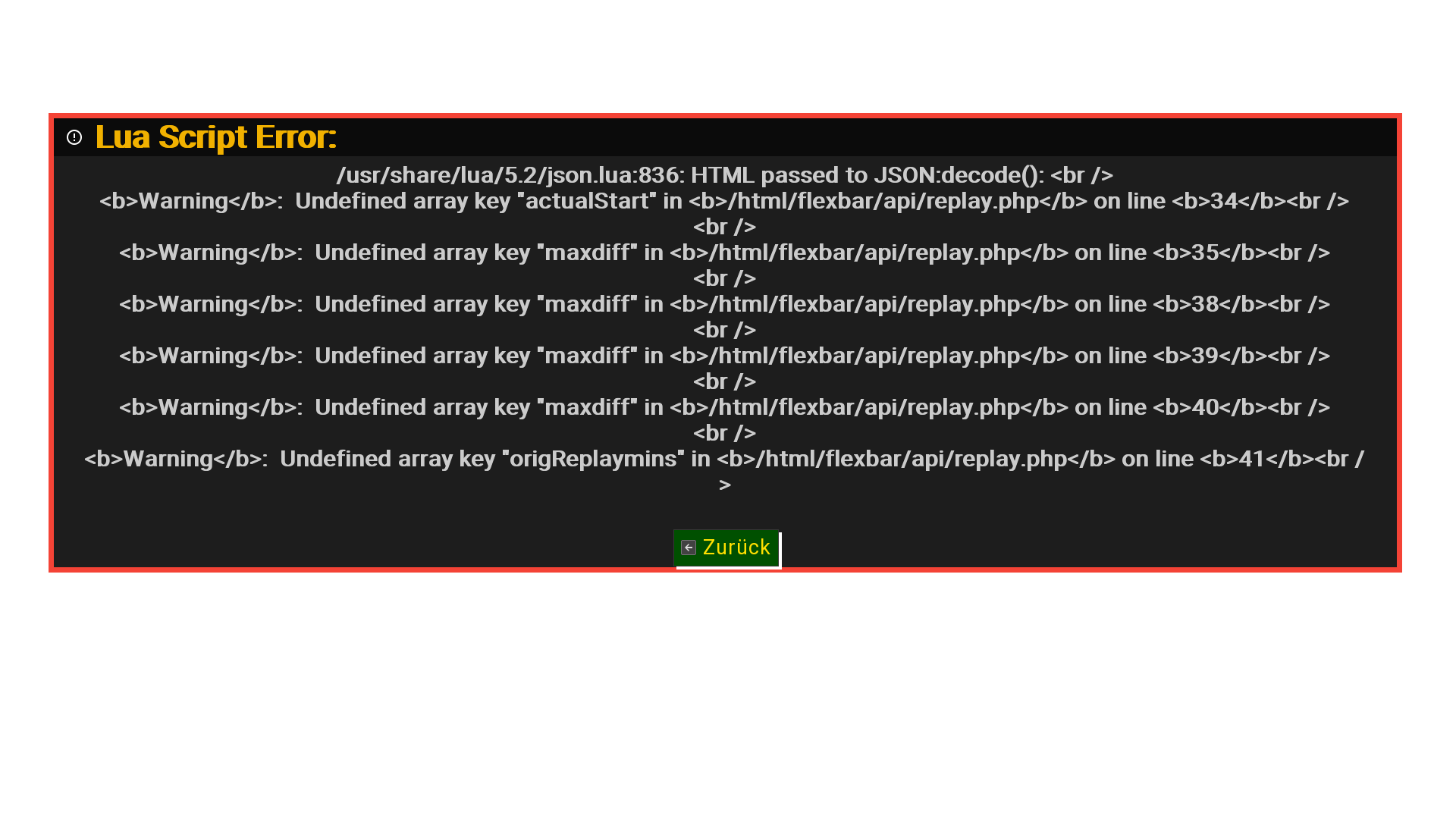

[CLuaInstance::runScript] error in script: /usr/share/lua/5.2/json.lua:1348: /usr/share/lua/5.2/json.lua:836: can't parse JSON at byte 1 of: cfg

[CLuaInstance::runScript] error in script: /usr/share/lua/5.2/json.lua:836: nil passed to JSON:decode()
Ich bekomme diese Fehlermeldung
