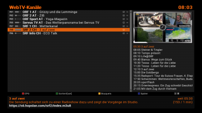

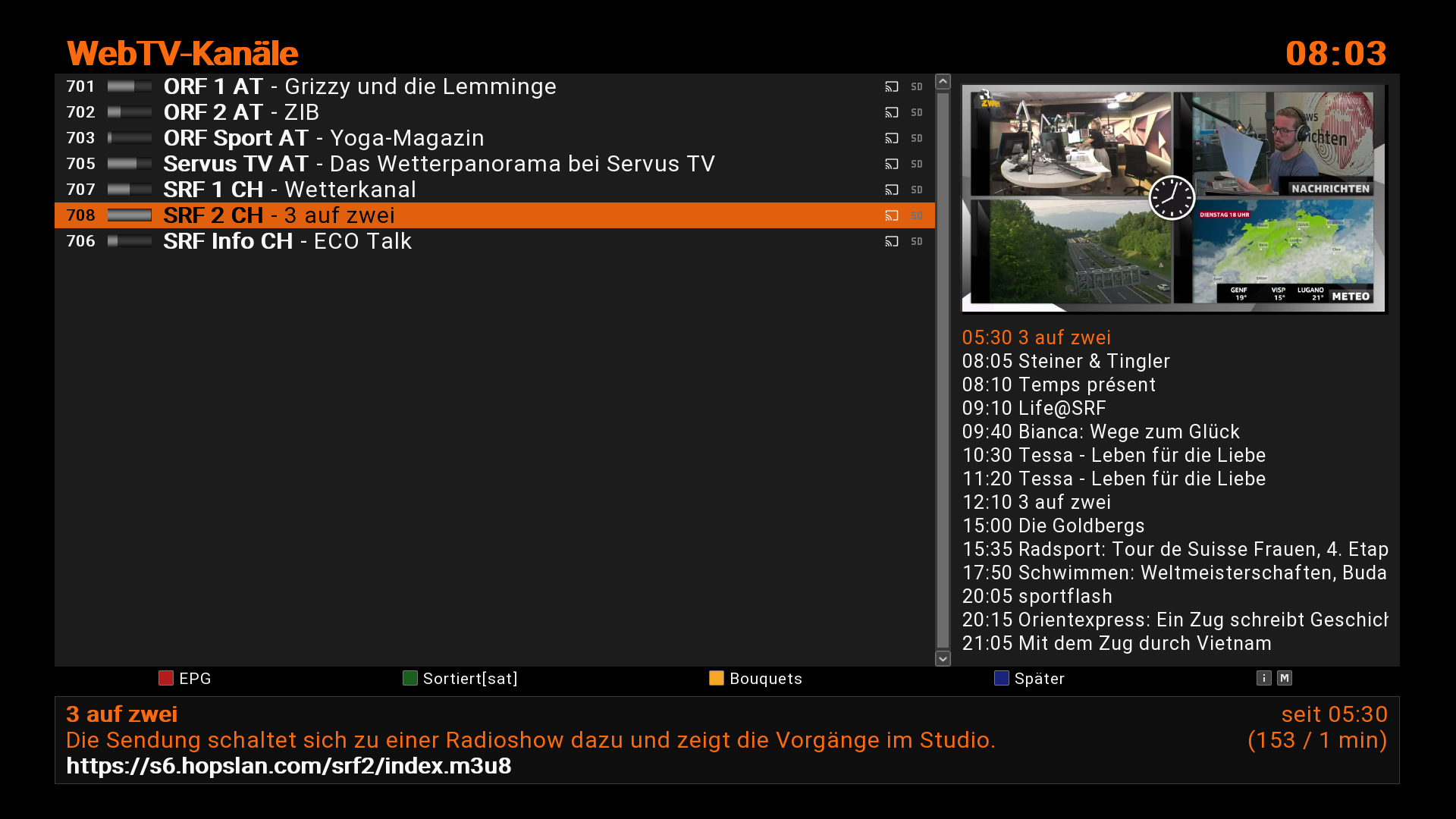

<webtvs name="ORF und SRF">
<webtv title="ORF 1 AT" url="https://s6.hopslan.com/orf11/index.m3u8" xmltv="https://iptv-org.github.io/epg/guides/de/hd-plus.de.epg.xml" epgmap="ORF1.at" script="best_bitrate_m3u8.lua" description="Livestream" />
<webtv title="ORF 2 AT" url="https://s6.hopslan.com/orf2/index.m3u8" xmltv="https://iptv-org.github.io/epg/guides/de/hd-plus.de.epg.xml" epgmap="ORF2.at" description="Livestream" />
<webtv title="ORF 3 AT" xmltv="https://iptv-org.github.io/epg/guides/de/hd-plus.de.epg.xml" epgmap="ORF3.at" description="Livestream" />
<webtv title="ORF Sport AT" url="https://s6.hopslan.com/orf3/index.m3u8" xmltv="https://iptv-org.github.io/epg/guides/de/hd-plus.de.epg.xml" epgmap="ORFSportPlus.at" url="http://212.18.115.193:3549/play/a05f/index.m3u8" description="Livestream" />
<webtv title="SRF 1 CH" url="https://s6.hopslan.com/srf1/index.m3u8" xmltv="https://iptv-org.github.io/epg/guides/de/hd-plus.de.epg.xml" epgmap="SRF1.ch" script="best_bitrate_m3u8.lua" description="Livestream" />
<webtv title="SRF 2 CH" url="https://s6.hopslan.com/srf2/index.m3u8" xmltv="https://iptv-org.github.io/epg/guides/ch/tv.blue.ch.epg.xml" epgmap="SRFzwei.ch" script="best_bitrate_m3u8.lua" description="Livestream" />
<webtv title="SRF Info CH" url="https://s6.hopslan.com/srfinfo/index.m3u8" xmltv="https://iptv-org.github.io/epg/guides/ch/tv.blue.ch.epg.xml" epgmap="SRFInfo.ch" script="best_bitrate_m3u8.lua" description="Livestream" />
<webtv title="Servus TV AT" url="https://s66.hopslan.com/servus/index.m3u8" xmltv="https://iptv-org.github.io/epg/guides/de/hd-plus.de.epg.xml" epgmap="ServusTVGermany.at" script="best_bitrate_m3u8.lua" description="Livestream" />
</webtvs>

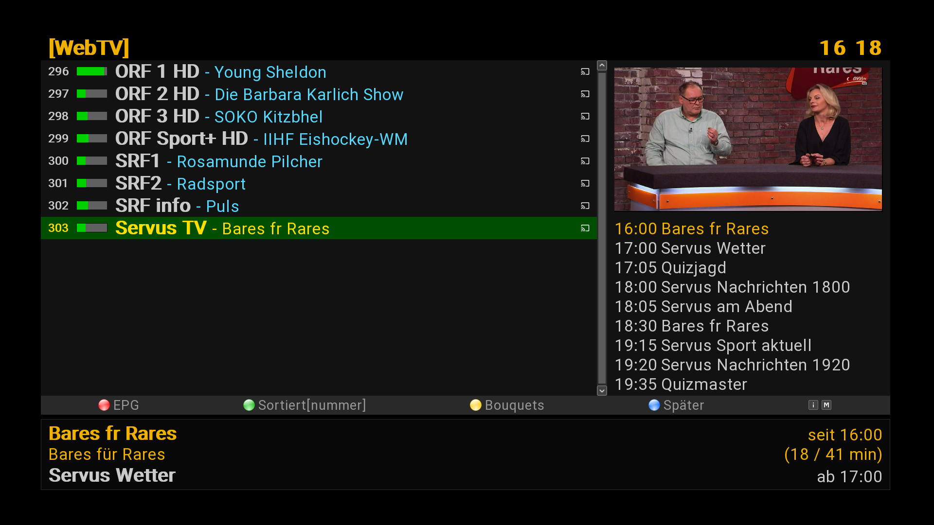

	<webtv title="ORF 1 HD" xmltv="https://iptv-org.github.io/epg/guides/at/tvheute.at.epg.xml" epgmap="ORF1.at" url="https://s6.hopslan.com/orf11/index.m3u8" description="Livestream" />
	<webtv title="ORF 2 HD" epgmap="ORF2.at" url="https://s6.hopslan.com/orf2/index.m3u8" description="Livestream" />
	<webtv title="ORF 3 HD" epgmap="ORF3.at" url="https://s6.hopslan.com/orf3/index.m3u8" description="Livestream" />
	<webtv title="ORF Sport+ HD" epgmap="ORFSport.at" url="http://212.18.115.193:3549/play/a05f/index.m3u8" description="Livestream" />
	<webtv title="SRF1" xmltv="https://iptv-org.github.io/epg/guides/ch/tv.blue.ch.epg.xml" epgmap="SRF1.ch" url="https://s6.hopslan.com/srf1/index.m3u8" script="best_bitrate_m3u8.lua" description="Livestream" />
	<webtv title="SRF2" epgmap="SRF2.ch" url="https://s6.hopslan.com/srf2/index.m3u8" script="best_bitrate_m3u8.lua" description="Livestream" />
	<webtv title="SRF info" epgmap="SRFInfo.ch" url="https://s6.hopslan.com/srfinfo/index.m3u8" script="best_bitrate_m3u8.lua" description="Livestream" />
	<webtv title="Servus TV" epgmap="ServusTV.at" url="https://s66.hopslan.com/servus/index.m3u8" script="best_bitrate_m3u8.lua" description="Livestream" />

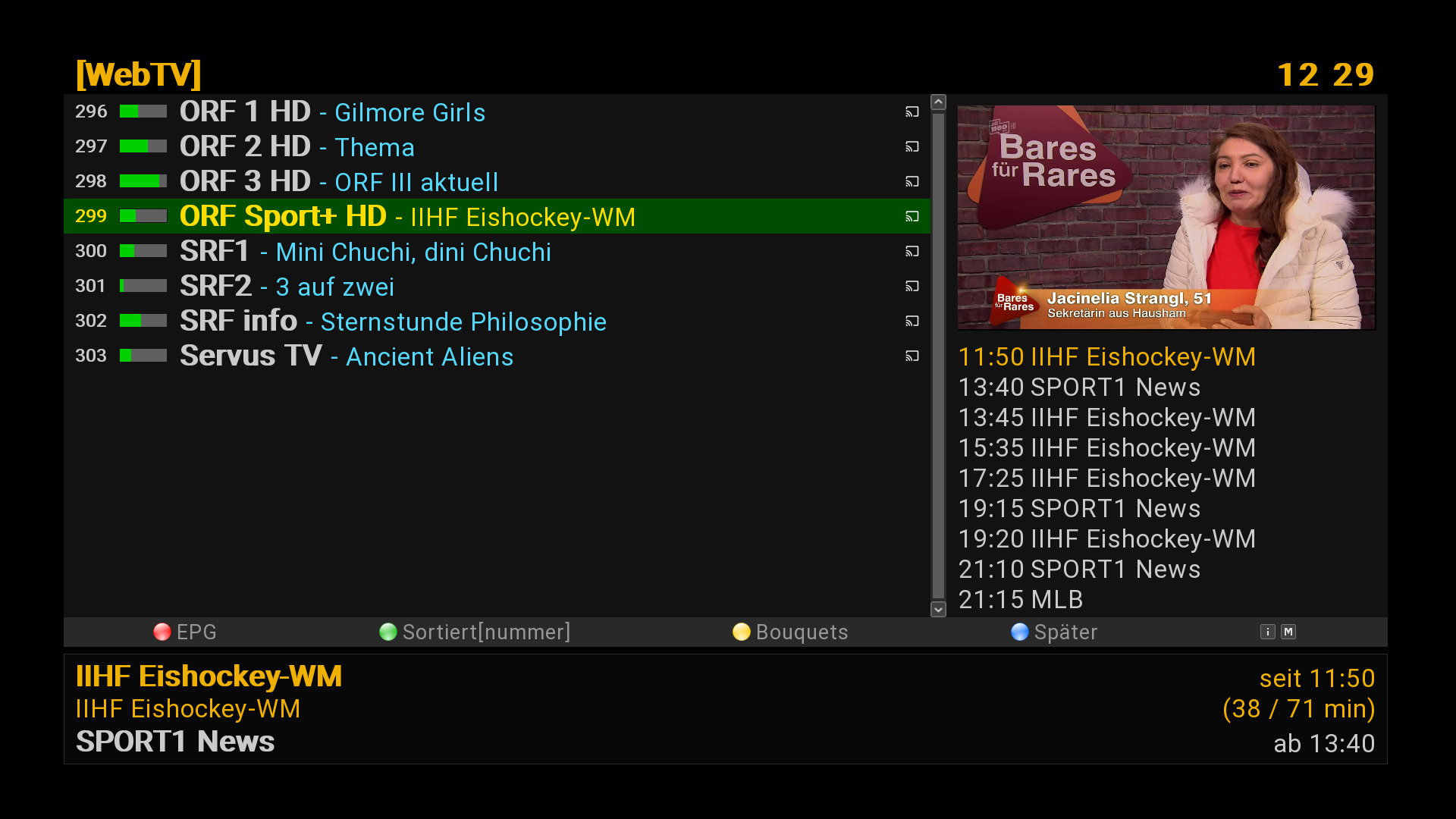

ne ne mein freund, siehe
Beiträge: 3169
Has thanked: 178 times
Been thanked: 48 times
Re: ORF mit WebTV
Dann nutzt Du aber eine andere Quelle wie hier:
Da wird aktuell dies ausgelesen:
<programme start="20220621100000 +0000" stop="20220621105800 +0000" channel="ServusTVGermany.at">
<title>Moderne Wunder</title>
<desc>
Nachtrag habe den Fehler gefunden
<webtv title="Servus TV" xmltv="https://iptv-org.github.io/epg/guides/at/tvheute.at.epg.xml" epgmap="ServusTVOsterreich.at" url="https://s66.hopslan.com/servus/index.m3u8" script="best_bitrate_m3u8.lua" description="Livestream" />
es war eine falsche ChanelID und die falsche Quelle. (bei Dir oben auch!)
