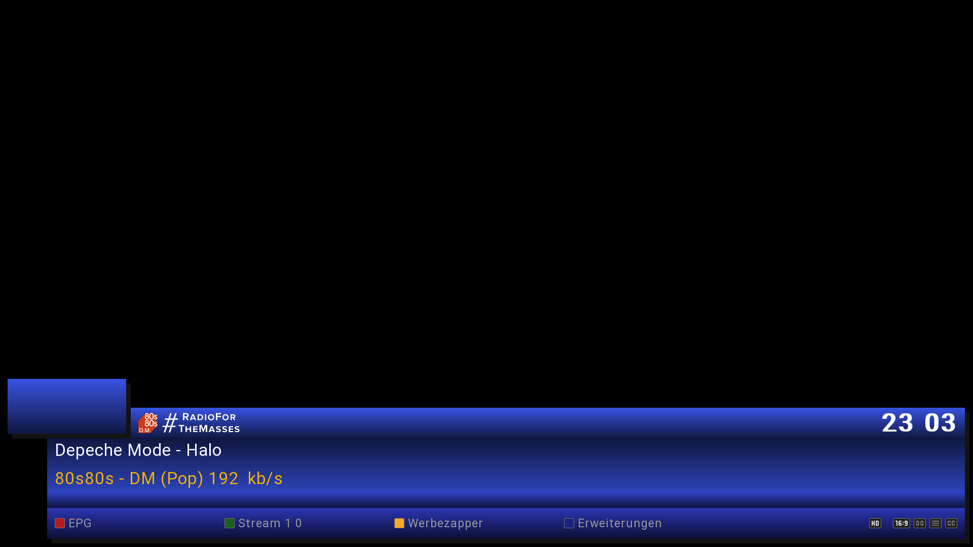

Beiträge: 574
Beitrag von satbaby »
Nein, nicht lokal war kaputt, nur jeder stream (webtv) metadata egal von wo.
Hier kam nur "no epg info"

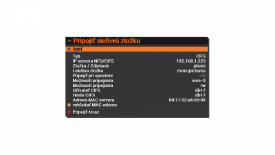

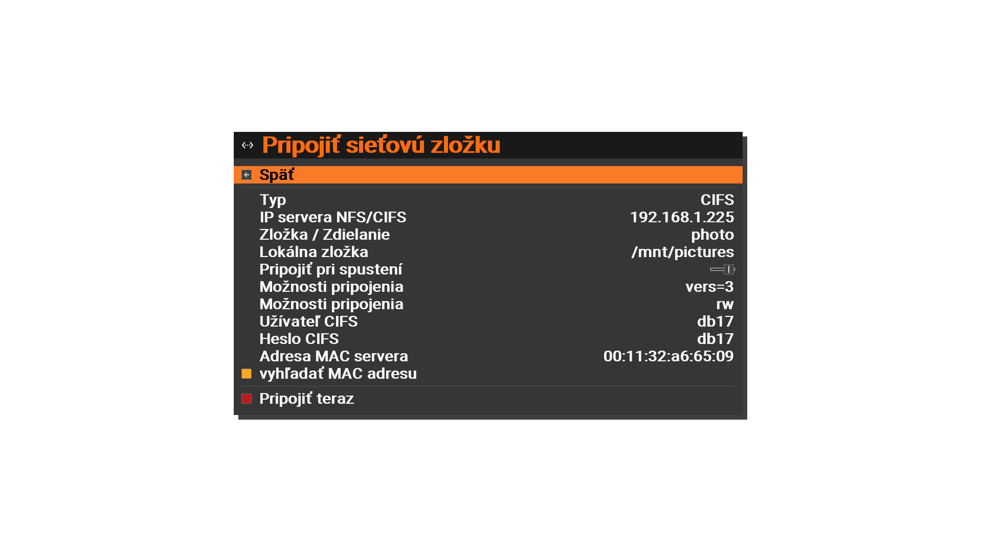

CIFS - bug command , ignored first line with command (vers=3), only next line with command insert (rw)
SUPPORT: NFS: 1, CIFS: 1, LUFS: 0
[CFSMounter] Mount(1) 192.168.1.225:photo -> /mnt/pictures
mount: mounting //192.168.1.225/photo on /mnt/pictures failed: Operation not supported
[CFSMounter] FS mount error: "mount -t cifs //192.168.1.225/photo /mnt/pictures -o username=db17,password=db17,rw"
ShowText ' CIFS //192.168.1.225/photo -> /mnt/pictures (auto: ▒no)'
replaced lines
mount: mounting //192.168.1.225/photo on /mnt/pictures failed: Invalid argument
[CFSMounter] FS mount error: "mount -t cifs //192.168.1.225/photo /mnt/pictures -o username=db17,password=db17,vers=3"
Gibertini OP100L /85E-53W/
