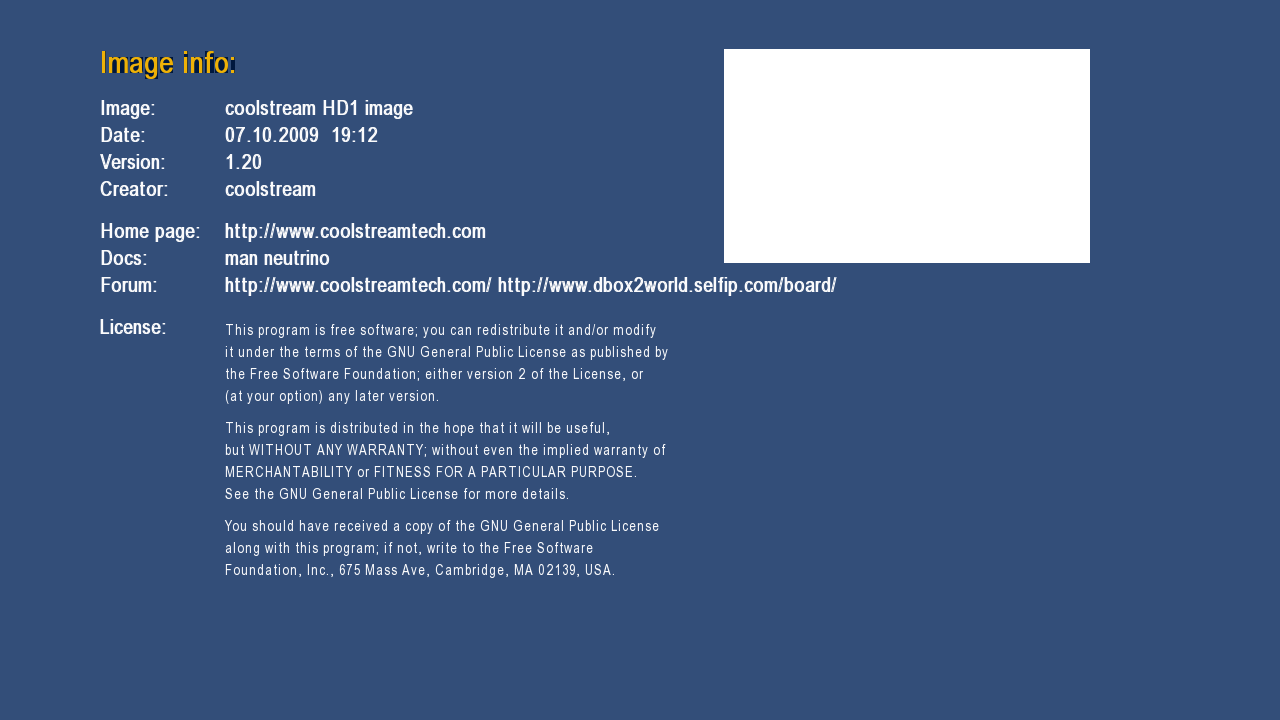

If I do a recovery to 1.20, the box boots normally
Wenn ich eine Wiederherstellung auf 1.20 durchführe, bootet die Box normal

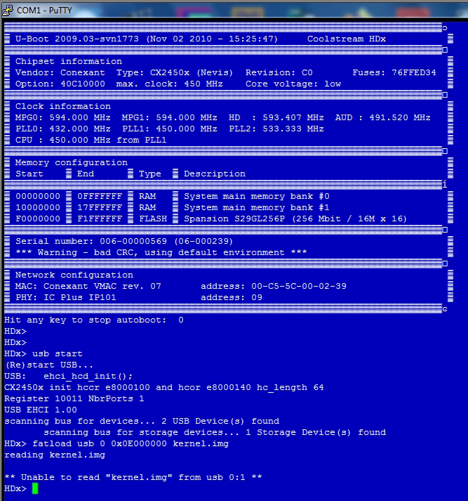

the new image segfaults and therefore the box reboots:
CSAPI (VIDEO): VIDEO: changing to 7: 720p 50Hz
CSAPI (VIDEO): SetVideoSystem: old Mode 2, new 2
CSAPI (VIDEO): SetVideoSystem: HD old uVideoStandard 22, new 22
CSAPI (VIDEO): HD Mode: 1280x720 FrameRate 5
CSAPI (VIDEO): SetVideoSystem: SD old uVideoStandard 4, new 4
CSAPI (VIDEO): Standby 1 -> 0
Segmentation fault
Jan 1 00:00:41 nevis user.info start_neutrino[691]: Neutrino exited with exit code 139
Jan 1 00:00:41 nevis user.info start_neutrino[691]: Rebooting due to REBOOT_ON_ERROR=true and exit code 139
Jan 1 00:00:41 nevis user.notice shutdown[721]: shutting down for system reboot
Jan 1 00:00:41 nevis daemon.info init: Switching to runlevel: 6
INIT: Switching to runlevel: 6
Jan 1 00:00:45 nevis syslog.info syslogd exiting
Jan 01 00:00:45 nevis user.info rcK[868]: start
Jan 01 00:00:45 nevis user.info rcK[868]: done
Restarting system.
U-Boot 2009.03-svn1773 (Nov 02 2010 - 15:25:47) Coolstream HDx
Chipset information
Vendor: Conexant Type: CX2450x (Nevis) Revision: C0 Fuses: 76FFED34
Option: 40C10000 max. clock: 450 MHz Core voltage: low
Clock information
MPG0: 594.000 MHz MPG1: 594.000 MHz HD : 593.407 MHz AUD : 491.520 MHz
PLL0: 432.000 MHz PLL1: 450.000 MHz PLL2: 533.333 MHz
CPU : 450.000 MHz from PLL1
Memory configuration
Start End Type Description
00000000 0FFFFFFF RAM System main memory bank #0
10000000 17FFFFFF RAM System main memory bank #1
F0000000 F1FFFFFF FLASH Spansion S29GL256P (256 Mbit / 16M x 16)
Serial number: 006-00000569 (06-000239)
*** Warning - bad CRC, using default environment ***
Network configuration
MAC: Conexant VMAC rev. 07 address: 00-C5-5C-00-02-39
PHY: IC Plus IP101 address: 09
Hit any key to stop autoboot: 1 0
## Booting kernel from Legacy Image at f0080000 ...
Image Name: NI Nevis Kernel
Data Size: 2273112 Bytes = 2.2 MB
Load Address: 00048000
Entry Point: 00048000
Verifying Checksum ... OK
Loading Kernel Image ... OK
OK
Starting kernel ...
But I can't tell you exactly why, sorry.
Maybe there is an error in the flash-cells of that box, that doesn't get triggered with the old (ancient!) image from 2009, because there simply is no important data at these cells, that can cause a segfault.
Or, the new image (i suppose it is a rather new one from 2024?) is broken in itself, and you are the first one to notice. In this case, i suggest to try an older image from last month or so, you can download one from here: https://neutrino-images.de/neutrino-ima ... ly/backup/
Good luck.
Bye,
edit: as a "last resort" you could also try the last "Release-Image" from 2017: https://neutrino-images.de/neutrino-ima ... 710191831/

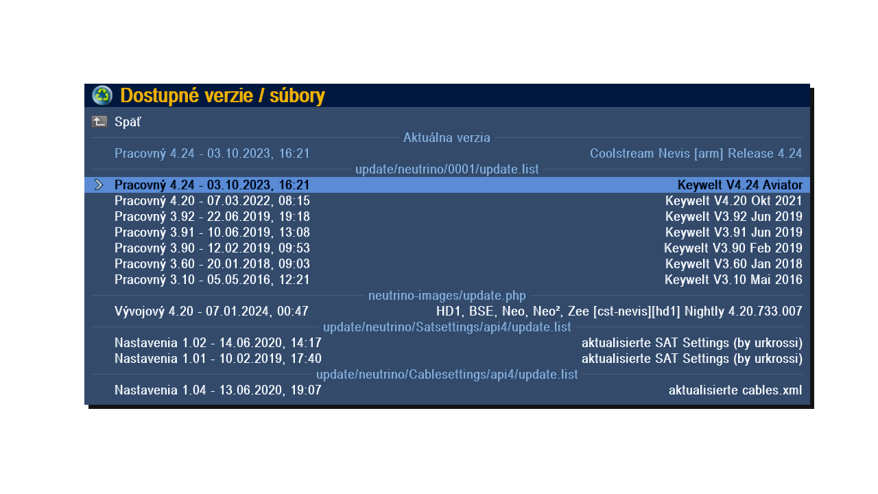

Thanks for the response.
So far I have managed to flash KeyWelt. I'll try uploading the older NI tomorrow. 4.20.733.007 will probably be wrong.

So even version 4.20.733.010 has the same problem :cry:
