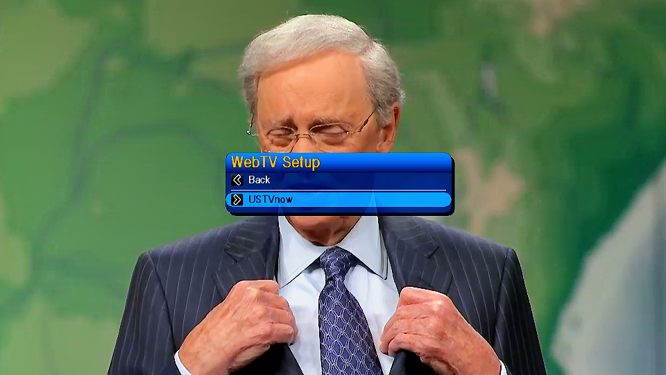

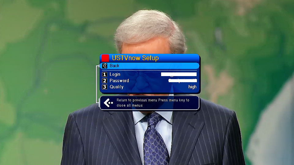

Setup USTVNow host:
- sign up an email login to http://www.ustvnow.com (7 HD channel ABC,NBC,CBS,FOX,CW,My9,PBS free!)
. start WebTV Setup pugin, select USTVnow host and enter login data
Use as WebTV normal channels

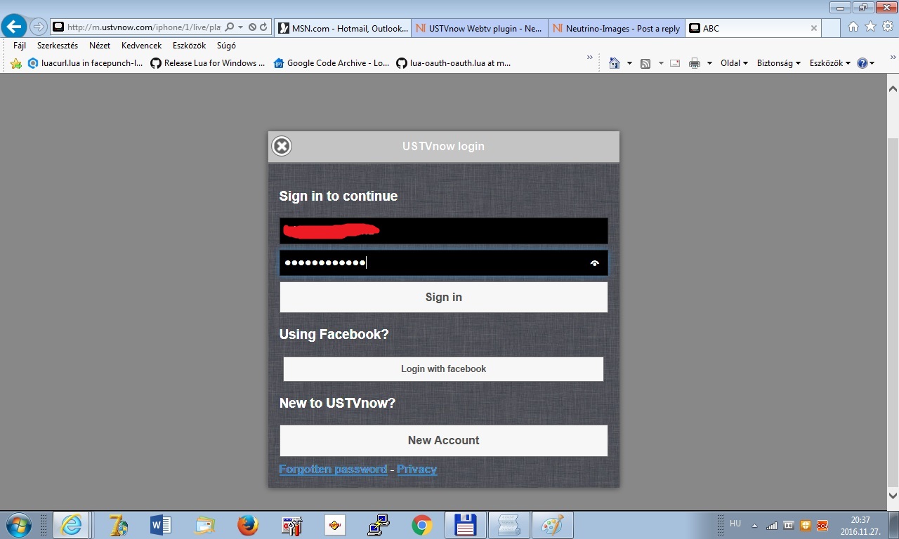

Is Your login correct?
Can you play channel with Browser? (Chrome)
Try it on this url:
http://m.ustvnow.com/iphone/1/live/playingnow
Celeburdi

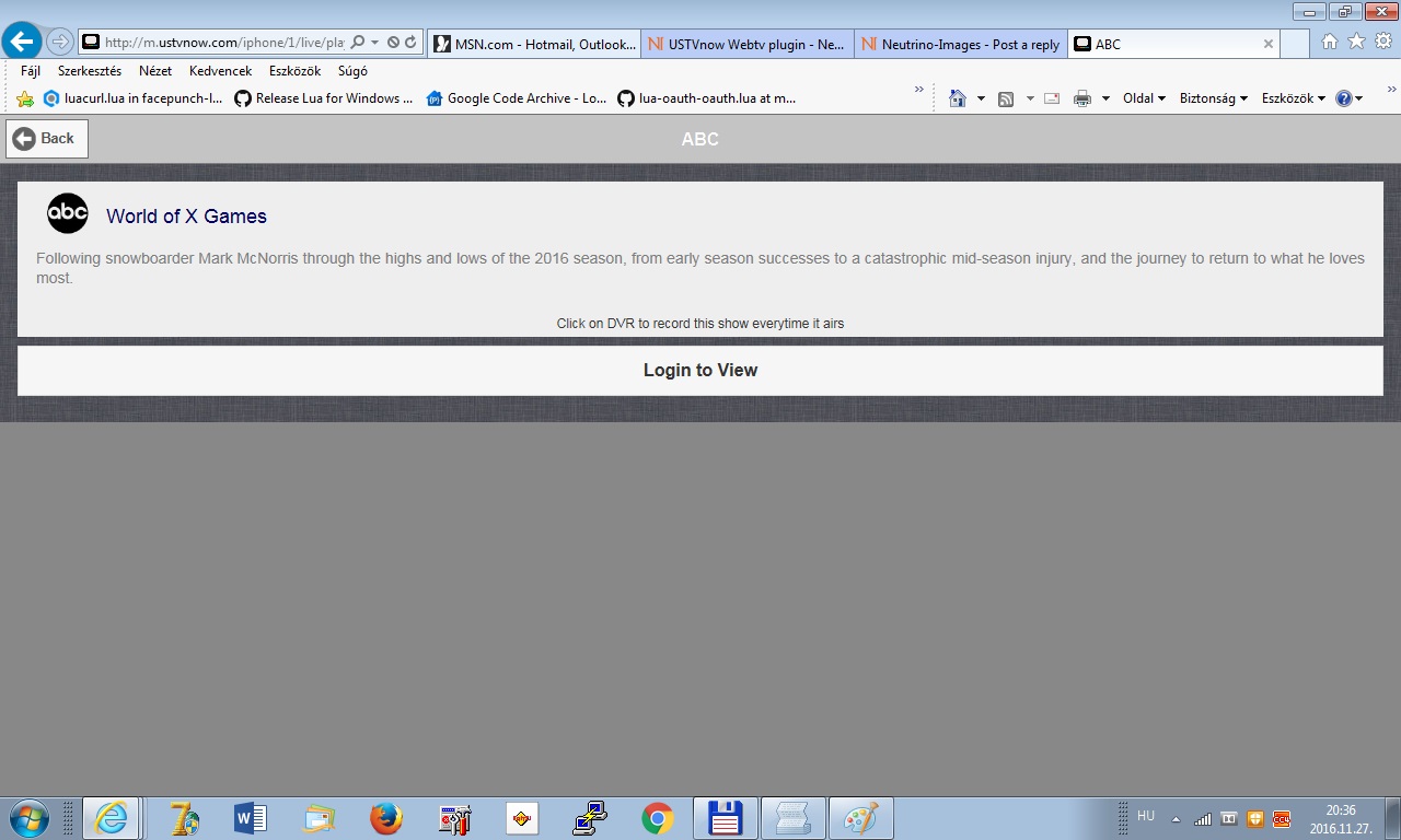

yes, that is working. And therefor I assume, that my login is correct.
no, that doesn't work: "USTVnow Login Failed. Go back to try again or click below if you forgot your password." But the password is definitely correct. So, that seems to be the problem, but why? How to debug this???

What type of login do you use?
This plugin works only with e-mail login.

I can login on this link:
The plugin uses this link for login.
bye
