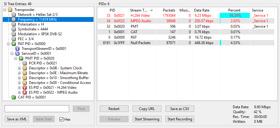

SCAN
maybe fixed scan transponders without SDT_table ?
etc.
[zapit] adding to scan HellasSat (39.0E) (position 390)
[femanager.cpp:getScanFrontend:760] Selected fe: 0
[zapit.cpp:StopPlayBack:2326] standby 0 playing 0 forced 0 send_pmt 1
[capmt.cpp:SetMode:288] channel b4de000000000001 [UNK (0x0000_0x0001)] mode 0 STOP src 0 mask 1 -> 0 update 0 rmode 0 mp 0
[capmt.cpp:SetMode:341]  (newmask == 0)
[ca_ci] -> SendCAPMT
TP: B4DE00000000

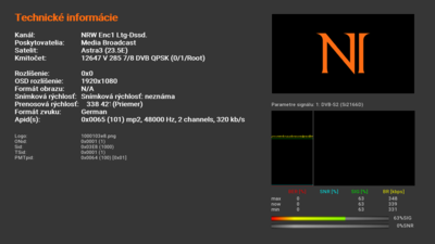

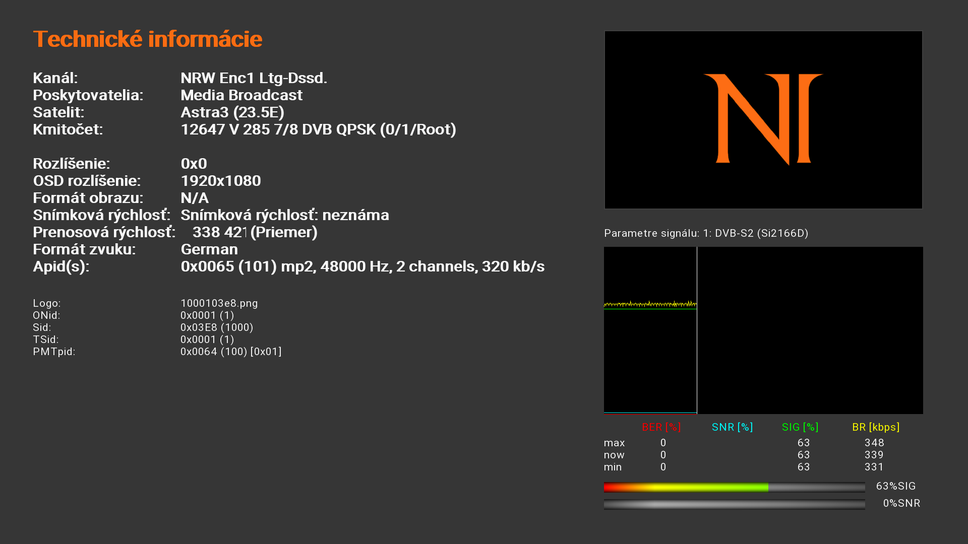

Gibertini OP100L /85E-53W/
EnoSat
Beiträge: 60
Wohnort: Slovakia
Box: MIO4K+ & HD51 & Solo4K
Beitrag von EnoSat »
for low SR not show BER and SNR
