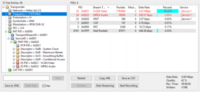

SCAN
maybe fixed scan transponders without SDT_table ?
etc.
[zapit] adding to scan HellasSat (39.0E) (position 390)
[femanager.cpp:getScanFrontend:760] Selected fe: 0
[zapit.cpp:StopPlayBack:2326] standby 0 playing 0 forced 0 send_pmt 1
[capmt.cpp:SetMode:288] channel b4de000000000001 [UNK (0x0000_0x0001)] mode 0 STOP src 0 mask 1 -> 0 update 0 rmode 0 mp 0
[capmt.cpp:SetMode:341]  (newmask == 0)
[ca_ci] -> SendCAPMT
TP: B4DE00000000
SID: 0001
SOURCE: 0
CA_MASK: 0
CALEN: 0
Scrambled: 0
Mode: 0
Enabled: STOP
[scan] scanning sat HellasSat (39.0E) position 390
[scan] NIT no, fta only: no, satellites single
[scan] tp-id 2cd2018600010001 freq 11474000 rate 4443000 fec 3 pol 0 mod 9 sys 2
[scan] add tp from settings: tp-id 2cd2018600010001 freq 11474000 rate 4443000 fec 3 pol 0 mod 9 sys 2
[scan] scanning tp from sat/service
[scan] scanning: tp-id 2cd2018600010001 freq 11474000 rate 4443000 fec 3 pol 0 mod 9 sys 2
[fe0/0] tune to 11474000 DVB-S2 8PSK 3/4 H/L srate 4443000 pli 0 plc 0 plm 3 (tuner 1724000 offset 9750000 timeout 4000)
ShowText 'scan: 0/1'
ShowText 'scan 1/1'

for low SR not show BER and SNR
