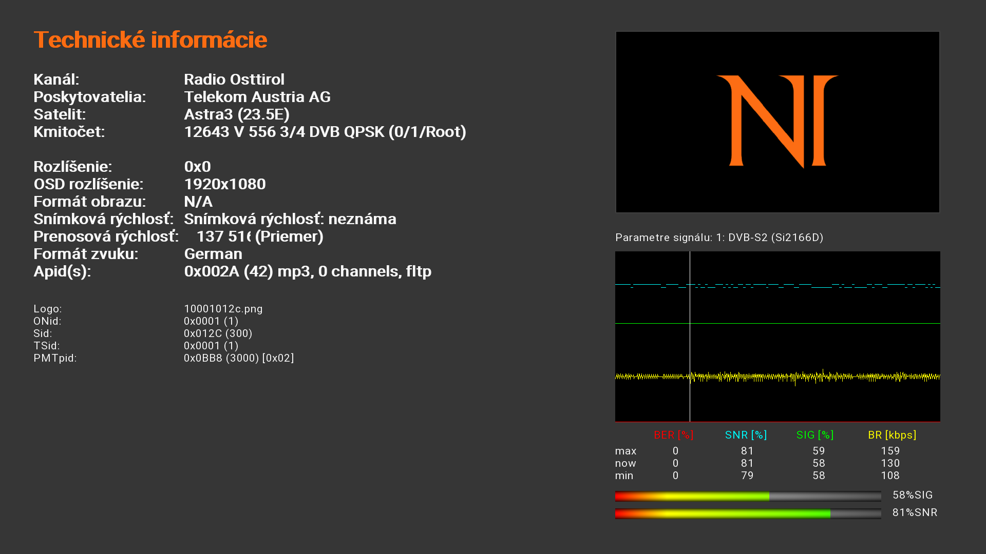

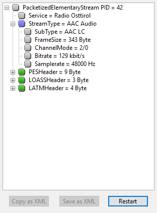

AAC from low SR not correct work (no sound)

Gibertini OP100L /85E-53W/
