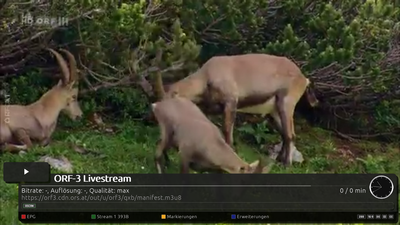

				Moin, grade mal probiert auf ORF3
funzt hier in .Also  sollte das ja bei dir auch gehen. was steht denn im log?
ShowText '===='
CLuaInstVideo::PlayFile: title ORF-3 Livestream file https://orf3.cdn.ors.at/out/u/orf3/qxb/manifest.m3u8
[movieplayer.cpp] executing /var/tuxbox/config/movieplayer.start.
PlayFileStart: starting...
stopPlayBack: stopping...
stopPlayBack: stopped
Startplay at 0 seconds
cutNeutrino: playing 1 isUPNP 0
IS FILE PLAYER: true
[LT:00ea4d98:play  ] Open - player output name: Output PlayMode: PLAYMODE_FILE
[LT:00ea4d98:play  ] Start - filename=https://orf3.cdn.ors.at/out/u/orf3/qxb/manifest.m3u8 vpid=0 vtype=0 apid=0 ac3=32639
10:46:31.001 cnThread: eit update filter, ch 0x03fb0001283d, current ver 0x09  got events 3 (not active)
minimal Probe: 0
AudioTrack List
        1 und - A_AAC
[LT:00ea4d98:play  ] SetSpeed playing 1 speed 1
returning false
[LT:00ea4d98:play  ] FindAllPids
AudioTrack List
        1 und - A_AAC
ShowText '> ORF-3 Livestream'
[ca_ci] -> GetNumberCISlots
CI: CAM not found
loop:1243 msg->MP: 80000014, data: 00000009
CMoviePlayerGui::UpdatePosition: spd 1 pos 75/1000 (925, 7%)
