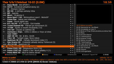

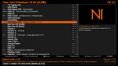

von EnoSat
Is it possible to fix the display of satellite names?
Ist es möglich, die Anzeige von Satellitennamen zu korrigieren?
Is it possible to fix the EPG?
Kann man das EPG reparieren?
Verfasst: Fr 31. Mär 2023, 06:24
von vanhofen
EnoSat hat geschrieben: ↑Do 30. Mär 2023, 21:38 Is it possible to fix the display of satellite names?
Yes, it's possible.
EnoSat hat geschrieben: ↑Do 30. Mär 2023, 21:38 Is it possible to fix the EPG?
Here i need your help. I don't understand the slovak language. Please send a UTF-8 encoded mapping list like this:

Verfasst: So 2. Apr 2023, 23:45
von EnoSat
vanhofen hat geschrieben: ↑Fr 31. Mär 2023, 06:24 Here i need your help. I don't understand the slovak language. Please send a UTF-8 encoded mapping list like this:
# from = to
 = ɨ
Fixed with encoding.conf (very old in image)
but not know why ř show as ł (but Ř displays correctly)
