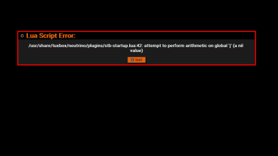

PS: after select Multiboot show this screen

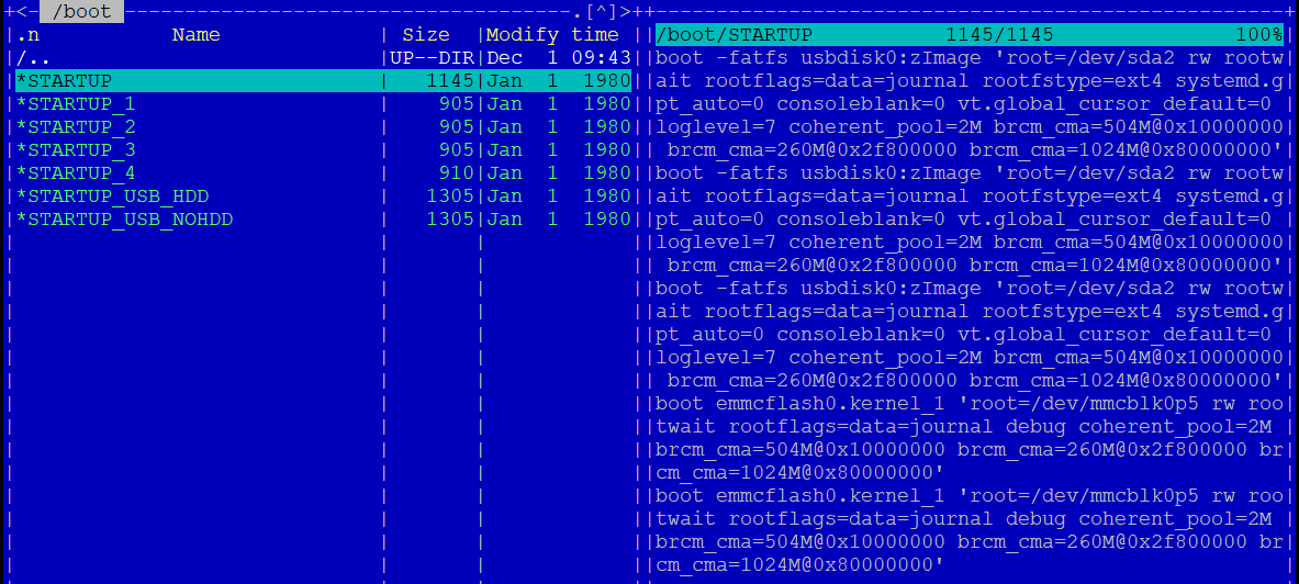

regarding the multiboot-error: does exist a file "/boot/STARTUP" and what is inside (it is just a textfile)?
