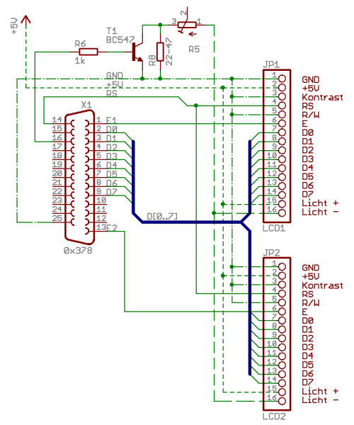

You can connect up to four displays on one bus (example schematic below), connecting all „RS“ lines and seperate all „Enable“ lines to one parallel port. The size of the displays is given with „Size1“, „Size2“, „Size3“ and „Size4“ and are automatically evaluated to form „Size“, so you can omit it, too. It is assumed that all displays (controllers) are one below the other to form „one big display“, with <rows> being the row-size of the biggest display. Edit the layout to correspond with the „Size“ parameter and you can control all displays at once.
Normally a HD44780-based display has 14 or 16 pins, where pins 15 and 16 are used for backlight. Power (+5V) must be supplied via pins 1(GND) and 2(+5V), be careful not to change polarity, you will destroy your display! Pin 3 is used to control the contrast, you can either hardwire it to GND (pin 1) or place a potentiometer (10k-20k) between pins 1 and 2, and connect pin 3 to the slider.
There are a lot of different wirings out there (lcdproc, WinAmp, …), so I decided to implement a parallel port abstraction layer which makes the wiring completely configurable! (this is what the Wire.xy entries in the configuration are for). This feature is available in V0.9.9, previous versions still use the default wiring. If you don't use the this default wiring scheme, you have to change these lines accordingly.
The wiring configuration uses abstract signal names (e.g. STROBE) instead of pin numbers on the parallel port. So here's a translation table:

Schematic:
I'm using a 'general purpose' interface board to quickly test various displays. It consists of a stabilized voltage regulator, a connector to the parallel port, the circuit to drive 8 LED's, and two potentiometers to control backlight and contrast. Here's the schematic and board (designed with eagle):
And here an example, two displays on one bus (16×4 and 20×2):
ATTENTION! Wrongly cabled on Picture! Pin 6 of Display 2 have to be connected to Pin 17 (SelectIn) of Paralellport!
