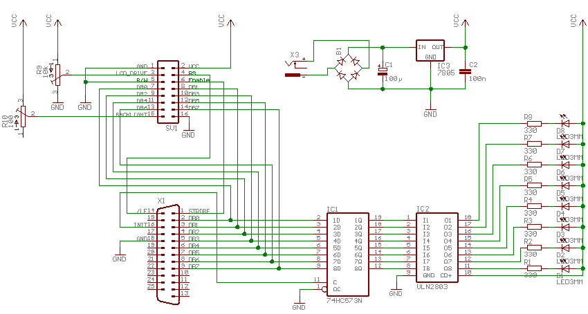

Schematic:
I built a little interface board to my TLC1091 display. It consists of a stabilized voltage regulator to create the +5V, a DC/DC converter to get the negative contrast voltage, a potentiometer to control the contrast (supplied with -12V) and a connector to the parallel port. The whole board needs +12V supply voltage. Here's the schematic and board (designed with eagle):
