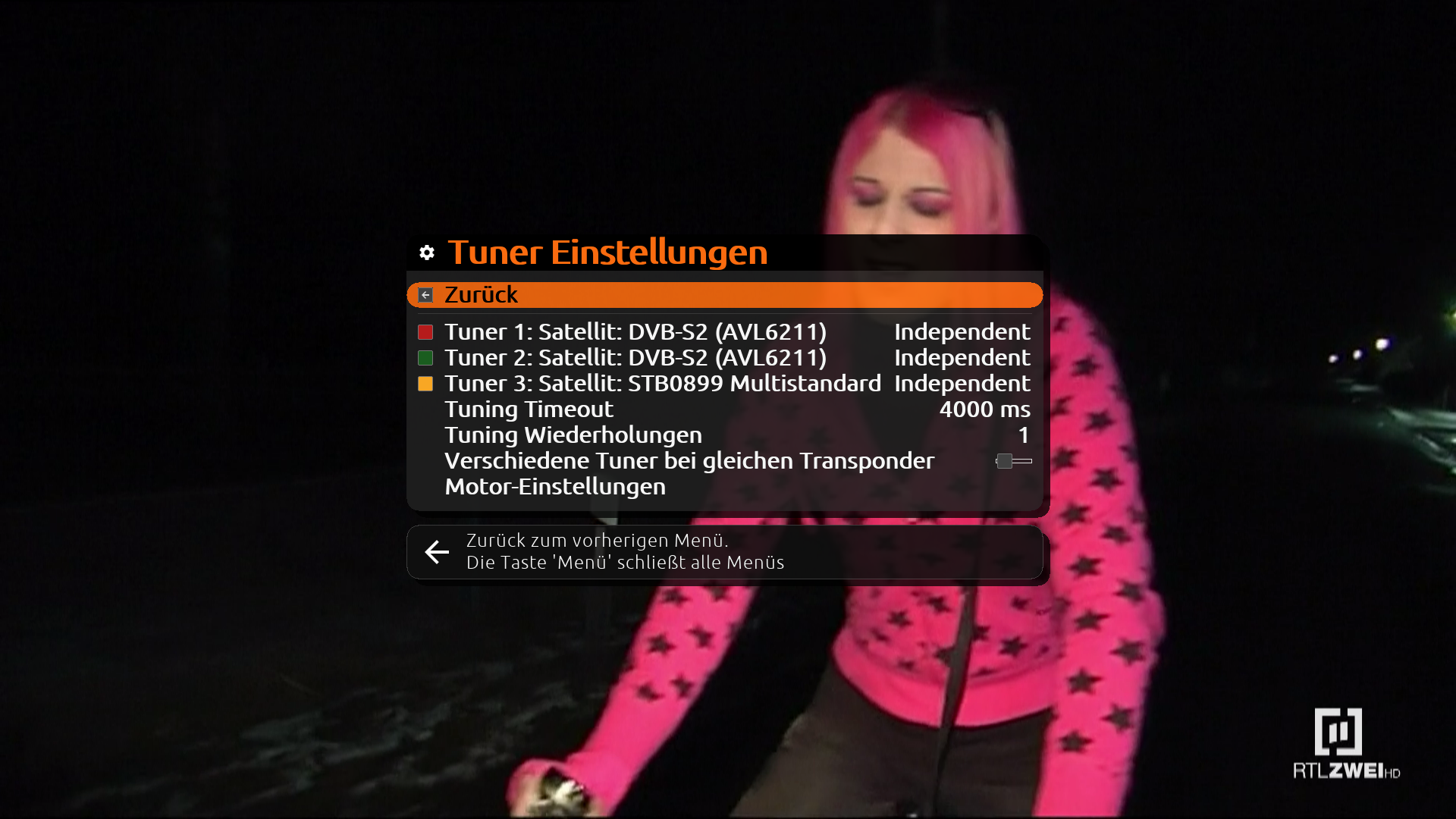

sieht dann zb. so aus
Firmware für den sky star über die Konsole mit wget geladen und nach /lib/firmware kopiert
Box neustart und tuner wird im Menu angezeigt
Sonst keine Zeit mehr heute, um was zu probieren.

[426437.306009] dvb-usb: found a 'Technisat SkyStar USB 2 HD CI' in cold state, will try to load a firmware
[426437.306112] usb 1-1.2: Direct firmware load for dvb-usb-az6027-03.fw failed with error -2
[426437.306119] dvb-usb: did not find the firmware file. (dvb-usb-az6027-03.fw) Please see linux/Documentation/dvb/ for more details on firmware-problems. (-2)
[426437.306142] dvb_usb_az6027: probe of 1-1.2:1.0 failed with error -2
[426437.306225] usbcore: registered new interface driver dvb_usb_az6027
[426634.741217] usb 1-1.2: USB disconnect, device number 5
[426637.228770] usb 1-1.2: new high-speed USB device number 6 using ehci-brcm
[426637.559300] dvb-usb: found a 'Technisat SkyStar USB 2 HD CI' in cold state, will try to load a firmware
[426637.559462] dvb-usb: downloading firmware from file 'dvb-usb-az6027-03.fw'
[426637.642098] dvb-usb: found a 'Technisat SkyStar USB 2 HD CI' in warm state.
[426637.642539] dvb-usb: will pass the complete MPEG2 transport stream to the software demuxer.
[426637.860442] dvbdev: DVB: registering new adapter (Technisat SkyStar USB 2 HD CI)
[426639.842458] stb0899_attach: Attaching STB0899
[426639.842465] stb6100_attach: Attaching STB6100
[426639.843269] usb 1-1.2: DVB: registering adapter 1 frontend 0 (STB0899 Multistandard)...
[426639.843555] input: IR-receiver inside an USB DVB receiver as /devices/platform/f0470300.ehci/usb1/1-1/1-1.2/input/input4
[426639.843711] dvb-usb: schedule remote query interval to 400 msecs.
[426639.843717] dvb-usb: Technisat SkyStar USB 2 HD CI successfully initialized and connected.
[NI-AX-102C5A] /var/root # Box neustart und tuner wird im Menu angezeigt

Die erste manuelle Einzelkanalsuche findet dann allerdings keine DVB-C oder DVB-T2-Sender, sondern die Programme des Satellitentransponders auf dem man zuletzt fernsehen geguckt hat.
Eine Gesamtsuche findet gar nichts, obwohl das animierte Echolotsymbol des Kanalsuche-Fensters sich immer mit einem grünen Streifen im schwarzen Kreis herumdreht. Das ist es normalerweise nur, wenn ein Kanal oder Transponder erfolgreich empfangen wird, ansonsten ist der sich drehende Streifen rot.
Thomas
- Beiträge: 169
- Wohnort: Grimma
Re: USB-Tuner möglich ?
das geht nicht, da die hardware nur 3 tuner unterstützt
4 funktionieren also nicht
kannst nur mal versuchen die anderen tuner auszuschalten ob du dann den usb ansprechen kannst
- Beiträge: 1652
- Has thanked: 19 times
- Been thanked: 39 times
also Neutrino unterstützt 4 Tuner, sonst könnte ich als kabel-geschädigter den 2. Kabeltuner meiner Tank garnicht nutzen...
Gut, du schriebst zwar, dass "die hardware nur 3 tuner unterstützt", aber inwiefern ist das eine Hardwaregeschichte???
Aber OK, soweit ich weiss, hat an einer Neutrinobox noch nie ein USB-Tuner funktioniert, aber das wäre ja mal prinzipiell ne geile Sache, ein dritter DVB-C-Tuner wäre schon schick (obwohl ich afaik bisher nie in die Verlegenheit gekommen bin).
Thomas
- Beiträge: 169
- Wohnort: Grimma
die hardware der BCM 7251S-Chip ist das Limit, der kann nur Signale von max. 3 Tunern verarbeiten
vlt. bringt broadcom update für die limitation der max 3 tuner, aber vermutlich nicht
- TangoCash
- Beiträge: 486
- Box: Mutant HD51
- Been thanked: 26 times
Faszinierend das dieselbe Diskussion jedes Jahr min 1x auftaucht.
Dann halt noch einmal:
Neutrino ist vom Source Code her fest auf "/dev/dvb/adapter0" festgetackert, erst wenn jemand das ganze in der libstb-hal aufdröselt, und dann ganze so dynamisch macht wie bei E2 z.b. ist es möglich USB-Tuner / Virtuelle Tuner / PiP usw zu nutzen.
Da bei dieser Geschichte allerdings die libstb-hal komplett, und der neutrino/zapit code größtenteils umgeschrieben werden muss , hat sich da noch niemand dazu erbarmt.
Und bevor wieder andere Diskution losgetreten werden:
Ich halte PERSÖNLICH die USB Tuner und PiP für Firlefanz, und werde deswegen auch nichts groß dran machen.
Wer das so nutzen will, soll halt E2 nutzen, OneofNine hat da einen Mega Neutrino Skin gemacht, und mit der neutrino Keymap merkt man dann eigentlich kaum einen Unterschied.
