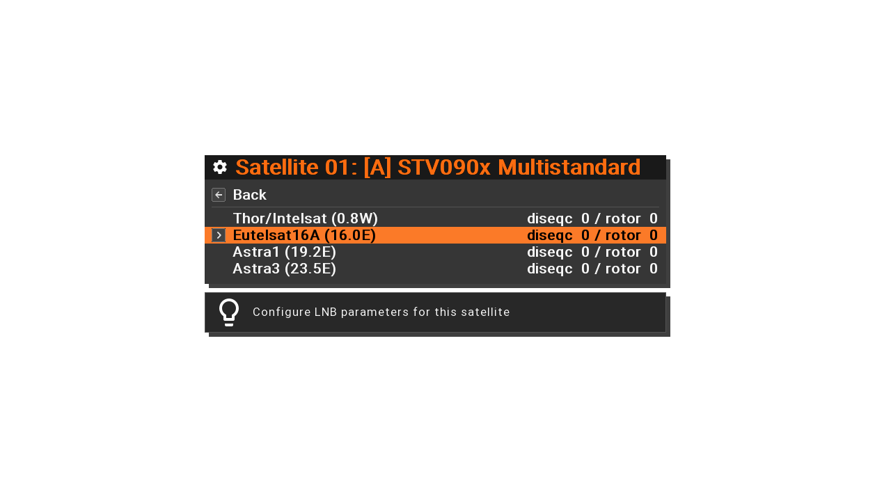

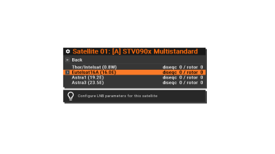

The frontend.conf file for Diseqc 8x1 is set up like this:
Die frontend.conf-Datei für Diseqc 8x1 ist wie folgt aufgebaut:
Port1-23E
Port2-19E
Port3-16E
Port7-1W
fe0_diseqcRepeats=2
fe0_diseqcType=4
fe0_diseqc_order=0
fe0_force_mode=0
fe0_highVoltage=1
fe0_lastSatellitePosition=160
fe0_master=0
fe0_mode=1
fe0_position_-8=-8,6,-1,6,0,0,9750,10600,11700,0,0,1
fe0_position_160=160,3,-1,3,0,0,9750,10600,11700,0,0,1
fe0_position_192=192,2,-1,2,0,0,9750,10600,11700,0,0,1
fe0_position_235=235,1,-1,1,0,0,9750,10600,11700,0,0,1
fe0_powered=1
fe0_rotor_swap=0
fe0_satellites=-8,160,192,235
fe0_uni_freq=0
fe0_uni_pin=0
fe0_uni_scr=0
fe0_use_usals=0
When scaning, it finds all available programs, but when switching to a found channel from 16E, the input switches to port0 (36E - not set, but verified for LOOP OUT).
Bei der Suche werden alle verfügbaren Programme gefunden, aber beim Umschalten auf einen gefundenen Kanal von 16E schaltet der Eingang auf Port 0 (36E - nicht gesetzt, aber auf LOOP OUT überprüft).
Any idea why it's doing this ?
Hat jemand eine Ahnung, warum das passiert ?

two things:
- Neutrino counts starting with Zero internally, but starts counting in the Menues with One, because we are humans and stupid. ;) So you have to keep that in mind.
- so you have set up the "ports" 1,2,3,7 (really seven, or rather four?) to the mentioned sats:
Port1-23E
Port2-19E
Port3-16E
Port7-1W
But in the frontend.conf your Tuner ist set to "-8,160,192,235" (8W,16E,19.2E,23.5E), do you see the error?
Bye,
edit1: regarding your post before, in the HD1-Images is Python not included, because that would be to big to fit in the flash.
edit2 (much later): my edit1 could have been wrong, it seems it could maybe a problem with yt-dlp.

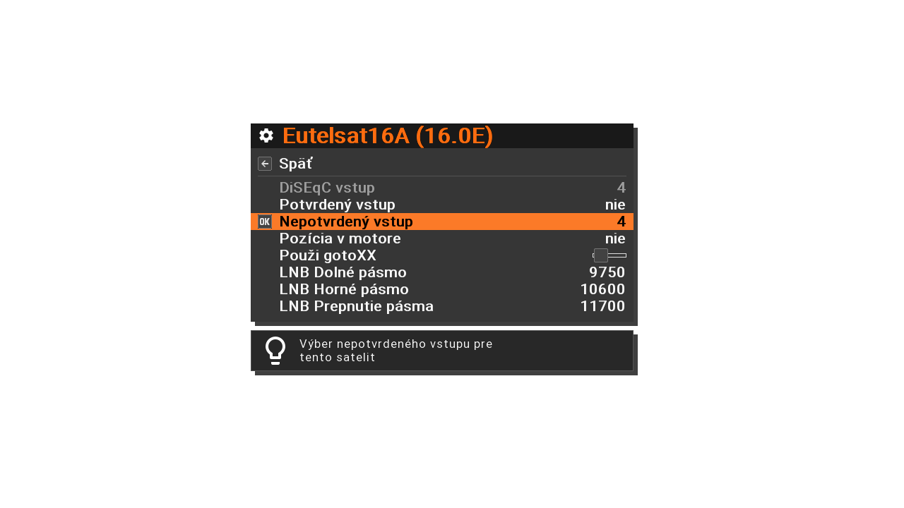

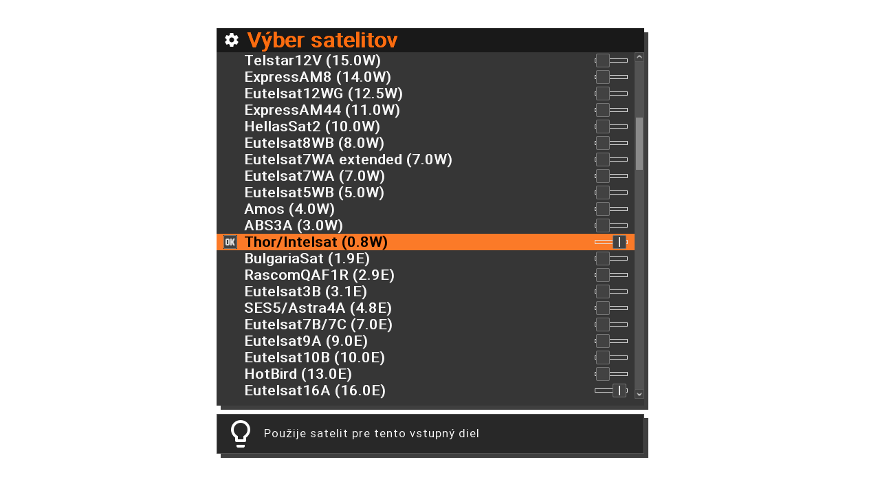

Thanks for your response.
LNB1 (Port0) - 36E
LNB2 (Port1) - 23E
LNB3 (Port2) - 19E
LNB4 (Port3) - 16E
LNB5 (Port4) - 13E (No LNB yet)
LNB6 (Port5) - 5E (No LNB yet)
LNB7 (Port6) - 1W
LNB8 (Port7) - 52E (No LNB yet)
As for -8, the system sets this itself after selection from the menu.
fe0_diseqcRepeats=0
fe0_diseqcType=4
fe0_diseqc_order=0
fe0_force_mode=0
fe0_highVoltage=0
fe0_lastSatellitePosition=0
fe0_master=0
fe0_mode=1
fe0_motorRotationSpeed=18
fe0_position_-8=-8,-1,-1,6,0,0,9750,10600,11700,0,0,1
fe0_position_160=160,-1,-1,3,0,0,9750,10600,11700,0,0,1
fe0_position_192=192,-1,-1,2,0,0,9750,10600,11700,0,0,1
fe0_position_235=235,-1,-1,1,0,0,9750,10600,11700,0,0,1
fe0_powered=0
fe0_rotor_swap=0
fe0_uni_freq=0
fe0_uni_pin=0
fe0_uni_scr=0
fe0_use_usals=0
I also tried manual editing to:
but the result seems to be the same, too with Advanced
If I understood it correctly:
160 - sat position
-1 - mini diseqc/diseqc1.0/unicable (0-16 or 0-1)
-1 - diseqc1.1 commited (0-16)
3 - diseqc1.1 uncommited (0-16)
0 - rotor position (0-64)
0 - ???
9750 - LNB LOF low
10600 - LNB LOF high
11700 - LNB LOF switch
0 - ???
0 - ???
1 - activated position/sat
Gibertini OP100L /85E-53W/
