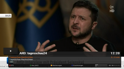

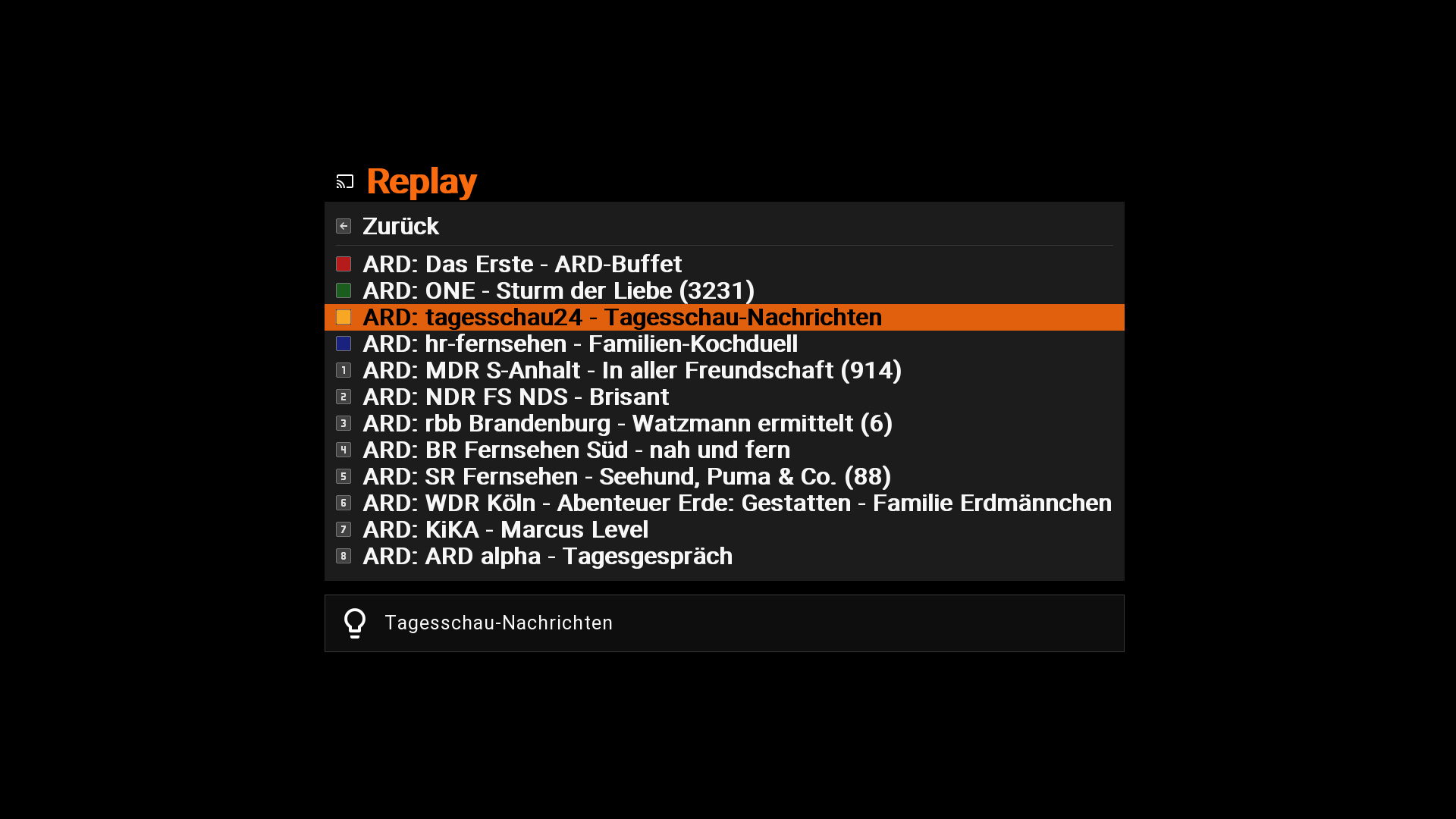

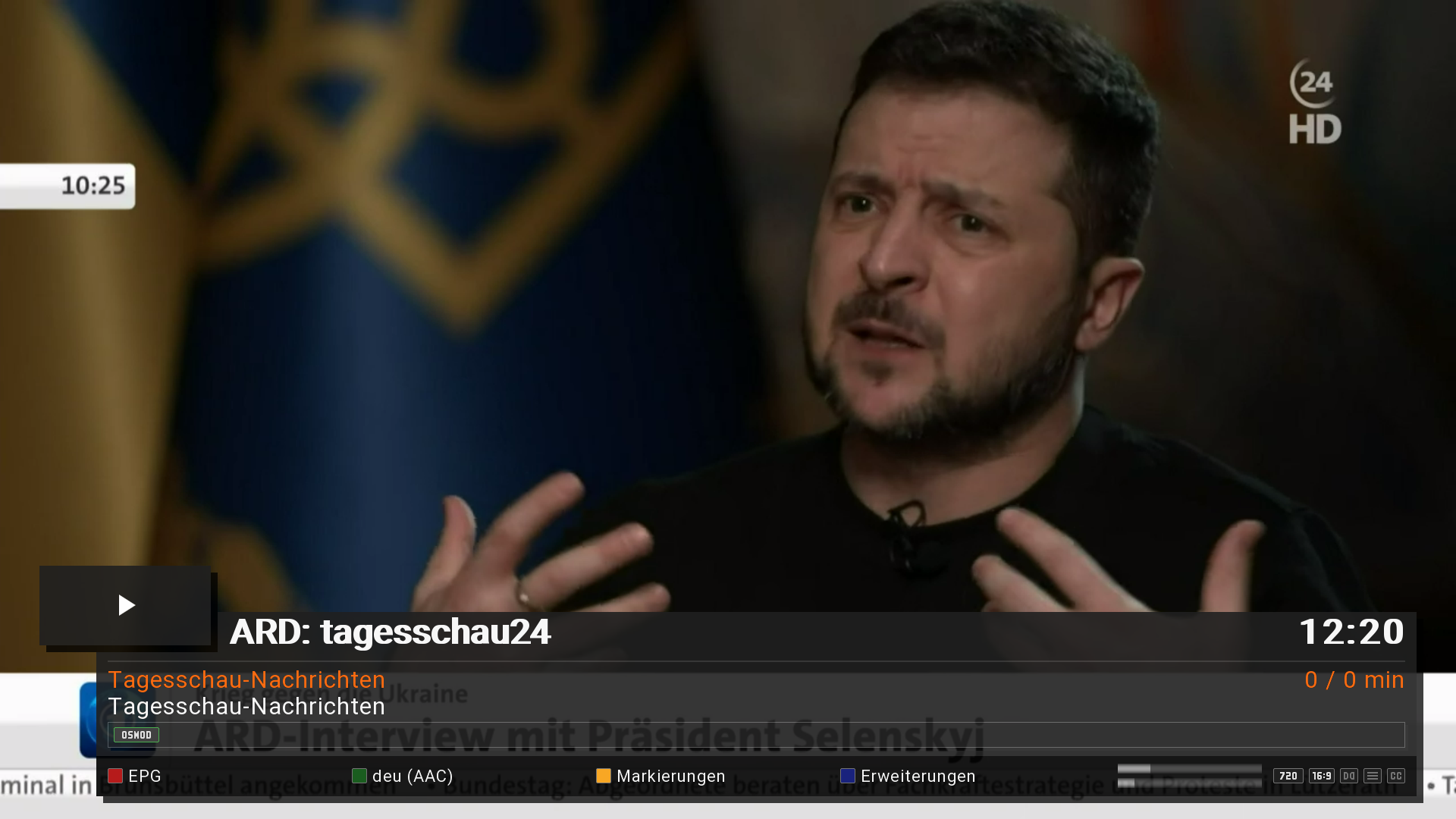

Gorcon hat geschrieben: Di 17. Jan 2023, 16:19Replay
Habe ich hier nicht, aber mal eben besorgt. Läuft einige Sekunden dann ist Ende. Allerdings weiß ich nicht wirklich wozu das gut sein soll, da das dem Live-Stream zu entsprechen scheint, und den brauche ich nicht wirklich.
Passendes Log dazu:
CLuaInstVideo::PlayFile: title ARD: Das Erste file http://itv.ard.de/replay/dyn/stream.php/1-6900/manifest.mpd
[neutrino] executing /var/tuxbox/control/movieplayer.start
PlayFileStart: starting...
stopPlayBack: stopping...
[HAL:00481ea0:play  ] RequestAbort
stopPlayBack: stopped
Startplay at 0 seconds
[zapit.cpp:StopPlayBack:2164] standby 0 playing 1 forced 0 send_pmt 1
[capmt.cpp:SetMode:238] PLAY: fe_num 0 dmx_src 0
[capmt.cpp:SetMode:307] channel bdf4043100016e2e [rbb Berlin] mode 0 STOP src 0 mask 1 -> 0 update 0
[ca_ci] -> SendCAPMT
TP: BDF404310001
SID: 6E2E
SOURCE: 0
CA_MASK: 0
CALEN: 0
Scrambled: 0
Mode: 0
Enabled: STOP
[dvb-sub] paused
cutNeutrino: old mode 1
cutNeutrino: new mode 7
cutNeutrino: save mode 1
CNeutrinoApp::handleMsg: CHANGEMODE to 7 rezap 0
[HAL:00481ea0:play  ] SetTeletextPid
IS FILE PLAYER: true
[HAL:00481ea0:play  ] Open - player output name: Output PlayMode: PLAYMODE_FILE
[HAL:00481ea0:play  ] Start - filename=http://itv.ard.de/replay/dyn/stream.php/1-6900/manifest.mpd vpid=0 vtype=0 apid=0 ac3=5 dev=0
minimal Probe: 0
AudioTrack List
        3 de - A_AAC
[HAL:00481ea0:play  ] FindAllPids
AudioTrack List
        3 de - A_AAC
[HAL:00481ea0:play  ] SetSpeed playing 1 speed 1
returning false
AudioTrack List
        3 de - A_AAC
AudioTrack List
        3 de - A_AAC
ShowText '> ARD: Das Erste'
AudioTrack List
        3 de - A_AAC
AudioTrack List
        3 de - A_AAC
loop:1320 msg->MP: 80000014, data: 0000000d
CMoviePlayerGui::UpdatePosition: spd 1 pos 95443714/1000 (-95442714, 179%)
CMoviePlayerGui::UpdatePosition: spd 1 pos 996/2000 (1004, 49%)
CMoviePlayerGui::UpdatePosition: spd 1 pos 1996/3000 (1004, 66%)
CMoviePlayerGui::UpdatePosition: spd 1 pos 2996/4000 (1004, 74%)
CMoviePlayerGui::UpdatePosition: spd 1 pos 3996/5000 (1004, 79%)
CMoviePlayerGui::UpdatePosition: spd 1 pos 4996/6000 (1004, 83%)
CMoviePlayerGui::PlayFileLoop: spd 1 pos 5996/7000 (1004, 85%)
CMoviePlayerGui::PlayFileLoop: spd 1 pos 6997/8000 (1003, 87%)
CMoviePlayerGui::PlayFileLoop: spd 1 pos 7998/9000 (1002, 88%)
CMoviePlayerGui::PlayFileLoop: spd 1 pos 8999/10000 (1001, 89%)
CMoviePlayerGui::PlayFileLoop: spd 1 pos 10000/11000 (1000, 90%)
CMoviePlayerGui::PlayFileLoop: spd 1 pos 11001/12000 (999, 91%)
CMoviePlayerGui::PlayFileLoop: spd 1 pos 12002/13000 (998, 92%)
CMoviePlayerGui::PlayFileLoop: spd 1 pos 13003/14000 (997, 92%)
CMoviePlayerGui::PlayFileLoop: spd 1 pos 14004/15000 (996, 93%)
CMoviePlayerGui::PlayFileLoop: spd 1 pos 15005/16000 (995, 93%)
CMoviePlayerGui::PlayFileLoop: spd 1 pos 16006/17000 (994, 94%)
CMoviePlayerGui::PlayFileLoop: spd 1 pos 17007/18000 (993, 94%)
CMoviePlayerGui::PlayFileLoop: spd 1 pos 18008/19000 (992, 94%)
CMoviePlayerGui::PlayFileLoop: spd 1 pos 19009/20000 (991, 95%)
CMoviePlayerGui::PlayFileLoop: spd 1 pos 20010/21000 (990, 95%)
CMoviePlayerGui::PlayFileLoop: spd 1 pos 21011/22000 (989, 95%)
CMoviePlayerGui::PlayFileLoop: spd 1 pos 22012/23000 (988, 95%)
CMoviePlayerGui::PlayFileLoop: spd 1 pos 23013/24000 (987, 95%)
2023-01-20 08:02:49.583 [sectionsd] Removed 488 old events (141907 left), zap detected 0.
CMoviePlayerGui::PlayFileLoop: spd 1 pos 24014/25000 (986, 96%)
CMoviePlayerGui::PlayFileLoop: spd 1 pos 25015/26000 (985, 96%)
CMoviePlayerGui::PlayFileLoop: spd 1 pos 26015/27000 (985, 96%)
CMoviePlayerGui::PlayFileLoop: spd 1 pos 27016/28000 (984, 96%)
CMoviePlayerGui::PlayFileLoop: spd 1 pos 28017/29000 (983, 96%)
CMoviePlayerGui::PlayFileLoop: spd 1 pos 29018/30000 (982, 96%)
CMoviePlayerGui::PlayFileLoop: spd 1 pos 30020/31000 (980, 96%)
CMoviePlayerGui::PlayFileLoop: spd 1 pos 31021/32000 (979, 96%)
CMoviePlayerGui::PlayFileLoop: spd 1 pos 32022/33000 (978, 97%)
CMoviePlayerGui::PlayFileLoop: spd 1 pos 33022/34000 (978, 97%)
CMoviePlayerGui::PlayFileLoop: spd 1 pos 34023/35000 (977, 97%)
CMoviePlayerGui::PlayFileLoop: spd 1 pos 35024/36000 (976, 97%)
CMoviePlayerGui::PlayFileLoop: spd 1 pos 36025/37000 (975, 97%)
CMoviePlayerGui::PlayFileLoop: spd 1 pos 37026/38000 (974, 97%)
CMoviePlayerGui::PlayFileLoop: spd 1 pos 38027/39000 (973, 97%)
CMoviePlayerGui::PlayFileLoop: spd 1 pos 39028/40000 (972, 97%)
CMoviePlayerGui::PlayFileLoop: spd 1 pos 40029/41000 (971, 97%)
CMoviePlayerGui::PlayFileLoop: spd 1 pos 41030/42000 (970, 97%)
CMoviePlayerGui::PlayFileLoop: spd 1 pos 42031/43000 (969, 97%)
CMoviePlayerGui::PlayFileLoop: spd 1 pos 43032/44000 (968, 97%)
CMoviePlayerGui::PlayFileLoop: spd 1 pos 44033/45000 (967, 97%)
CMoviePlayerGui::PlayFileLoop: spd 1 pos 45034/46000 (966, 97%)
CMoviePlayerGui::PlayFileLoop: spd 1 pos 46035/47000 (965, 97%)
CMoviePlayerGui::PlayFileLoop: spd 1 pos 47036/48000 (964, 97%)
CMoviePlayerGui::PlayFileLoop: spd 1 pos 48037/49000 (963, 98%)
Ab 96% dann Standbild obwohl der Player intern weiterläuft.

Hat nichts mit dem Server zu tun. Die Box hängt sich beim Start des Films komplett auf. Film aufnehmen und dann abspielen geht aber.
Ich brauche es aber Du kannst damit halt jede ARD Sendung von Anfang starten (und so lange schauen wie Du willst).
Funktioniert auf jeder Box mit mehr als einem Tuner und mit genug Leistung (CPU).
[/quote]Hat mit der Anzahl der Tuner nichts zu tun wenn man es für Webstreams nutzt. (für Tunerbetrieb gibts ja schließlich PIP.

@Gorcon: Der Test mit Replay war übrigens auch noch auf einer Ultimo4K mit gleichem Ergebnis. Aber wenn das mit dem Replay so ein sollte wie Du schreibst, dann funktioniert hier bereits der Sendungsstart nicht.
