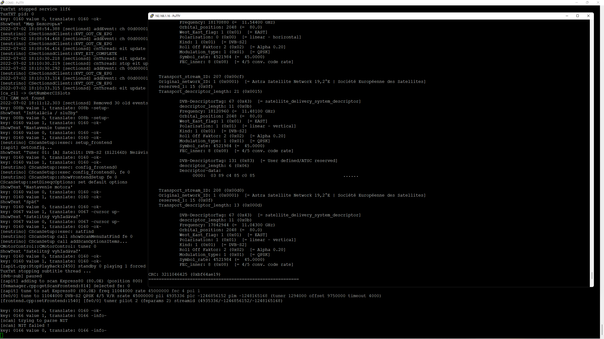

DVB-S2 (system="1" ) Transponders with multistream attributes are mapped to DVB-S2X Transponders, which are internally handled by 0x1000 = 4096.
Can u submit a log from neutrino start, when the frontends are detected ? ( I think the frontend detection routine has a bug, and did not detect the frontends correctly)
Should be lines like this: "[fe0/0] add delivery system DVB-S2X (delivery_system: 2 / Multistream: yes)"

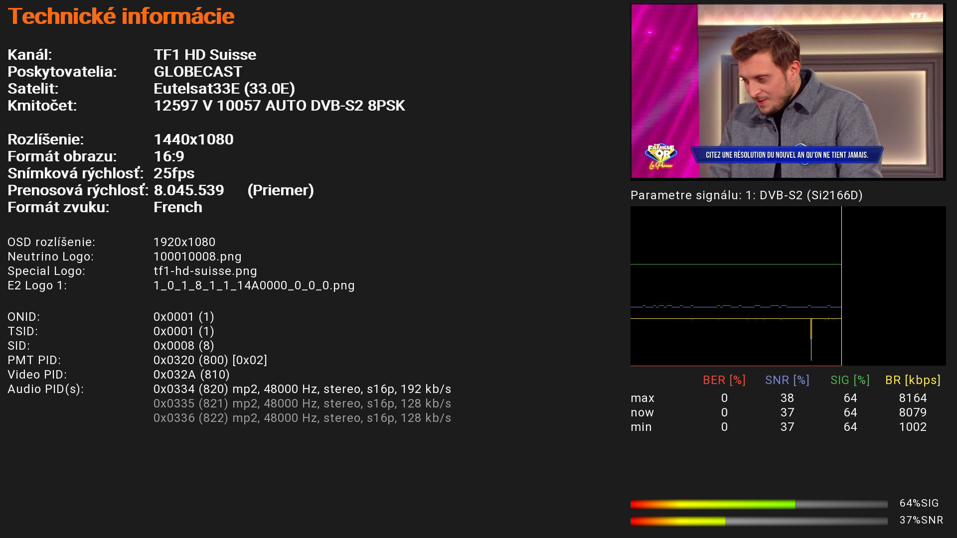

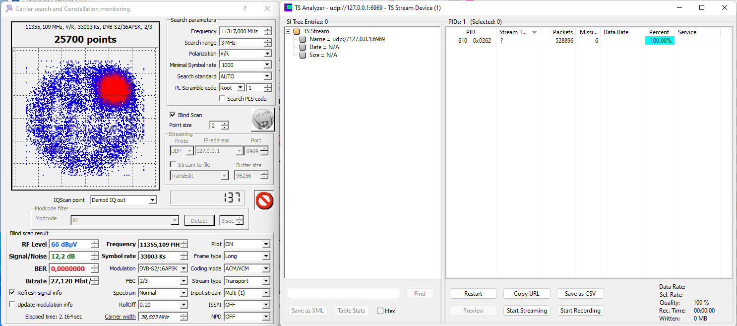

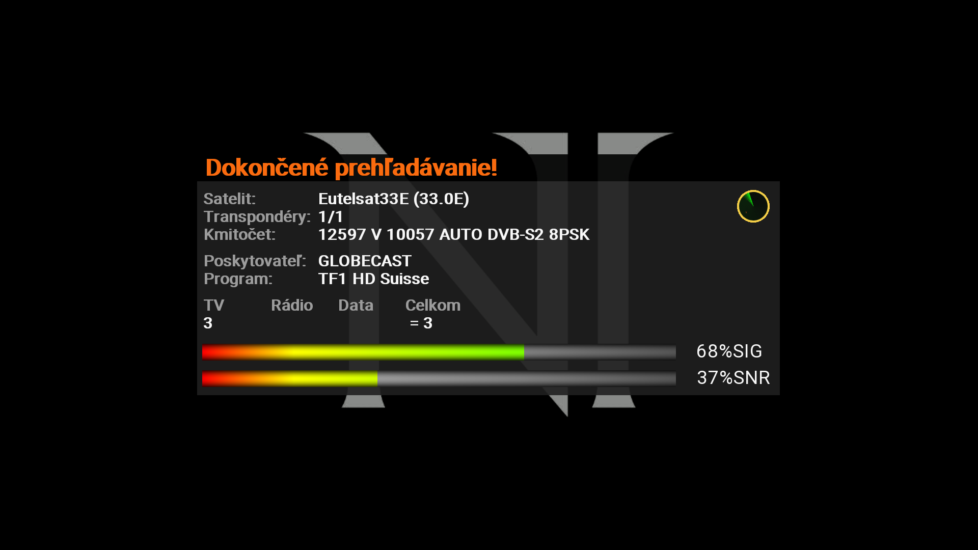

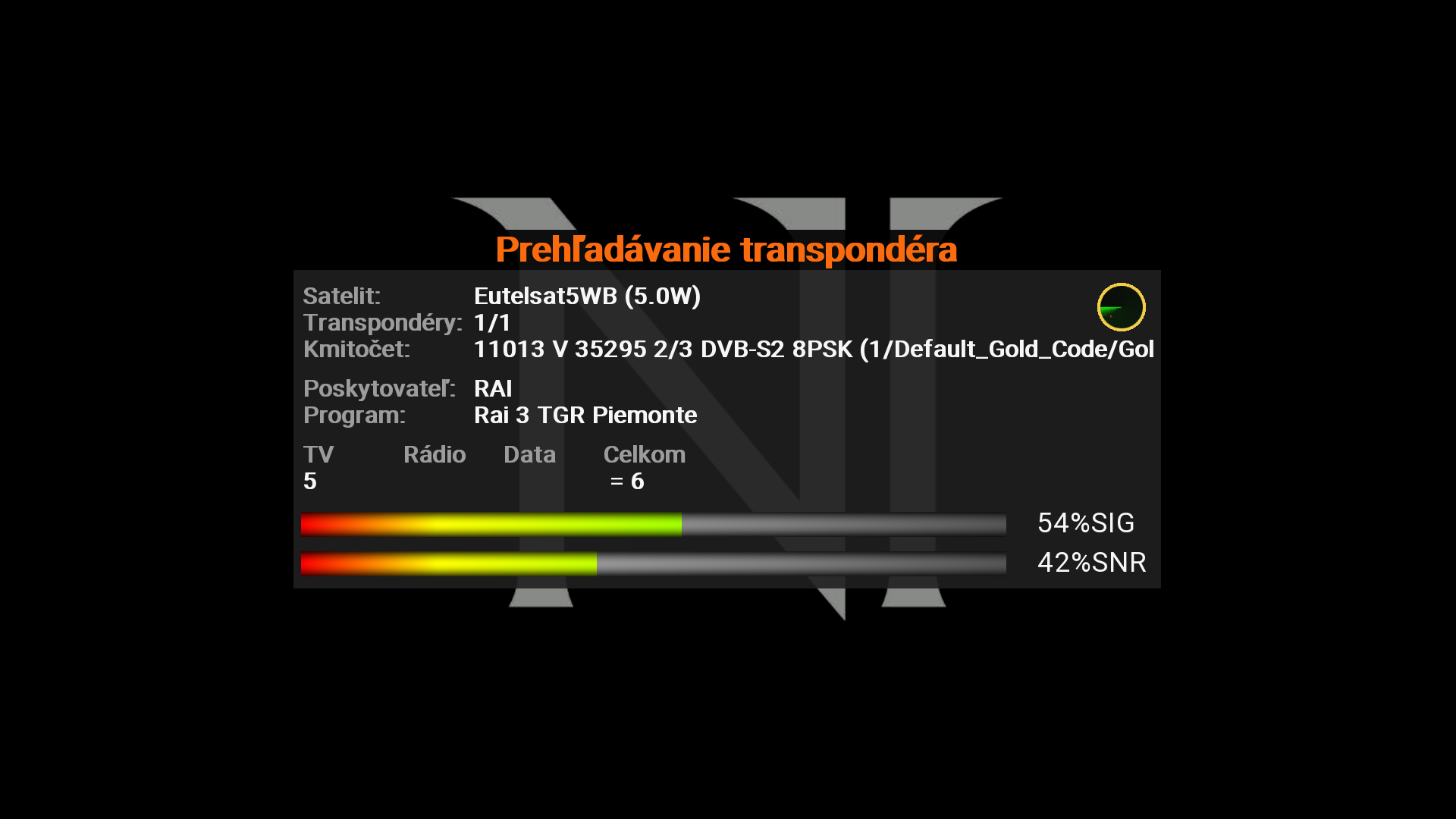

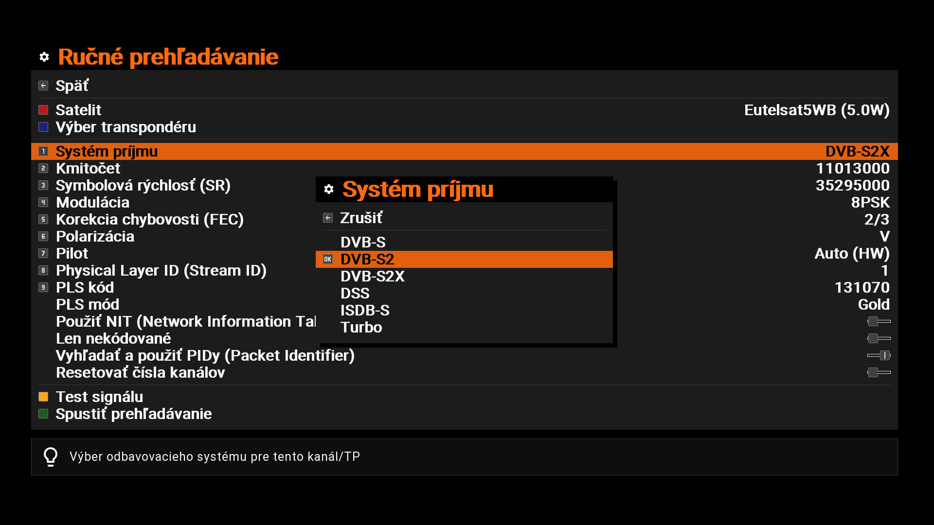

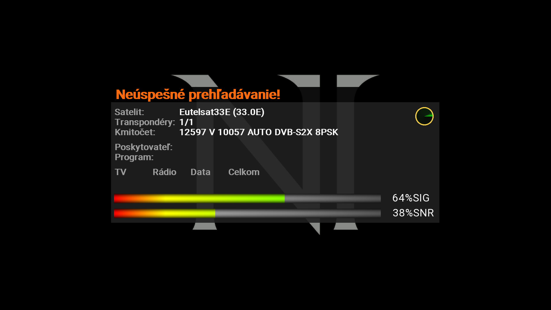

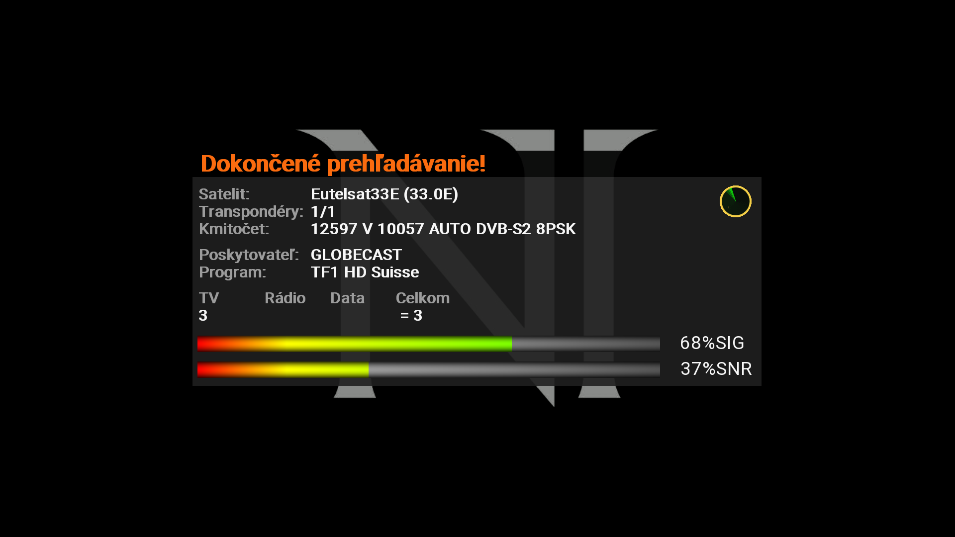

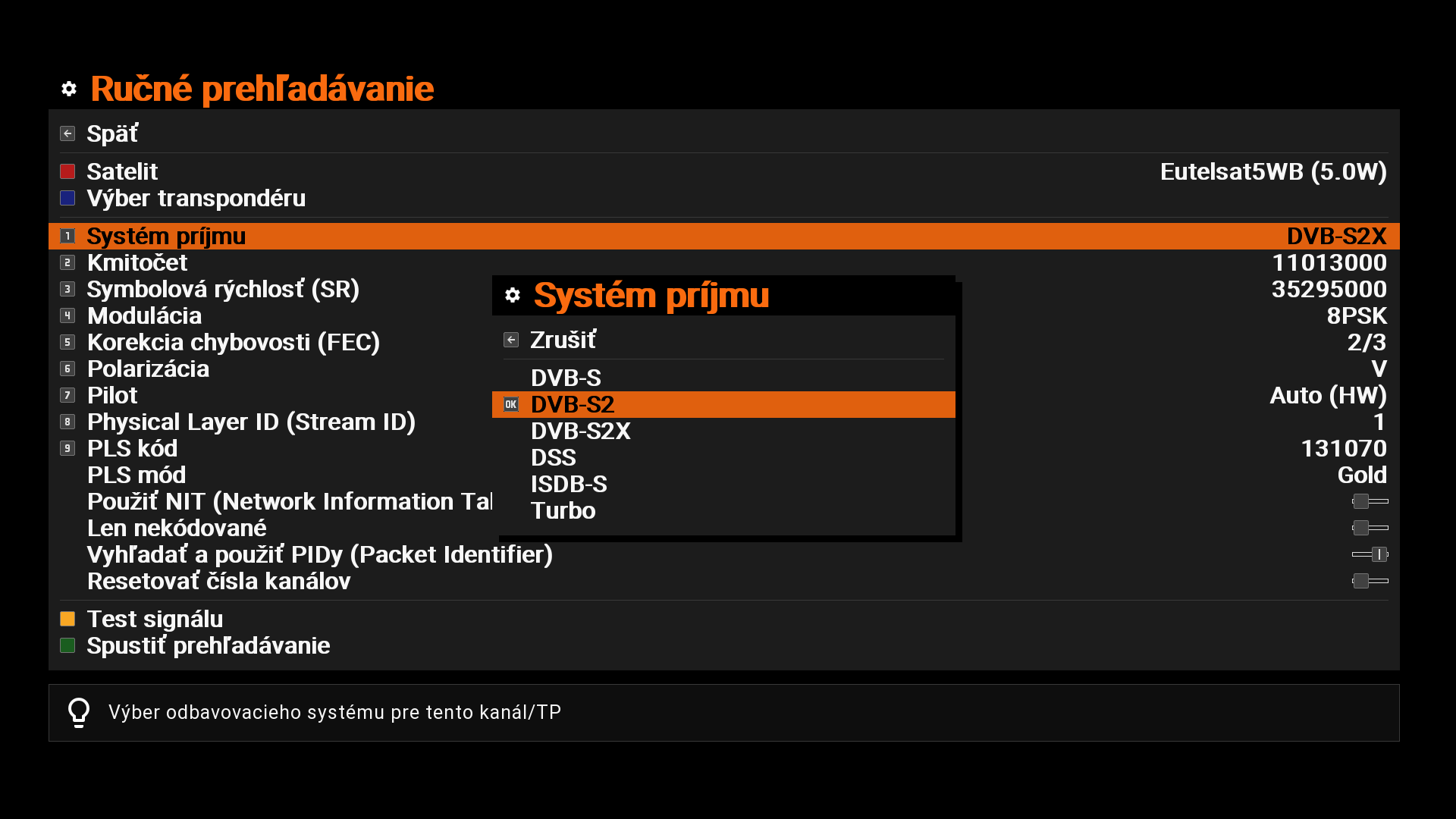

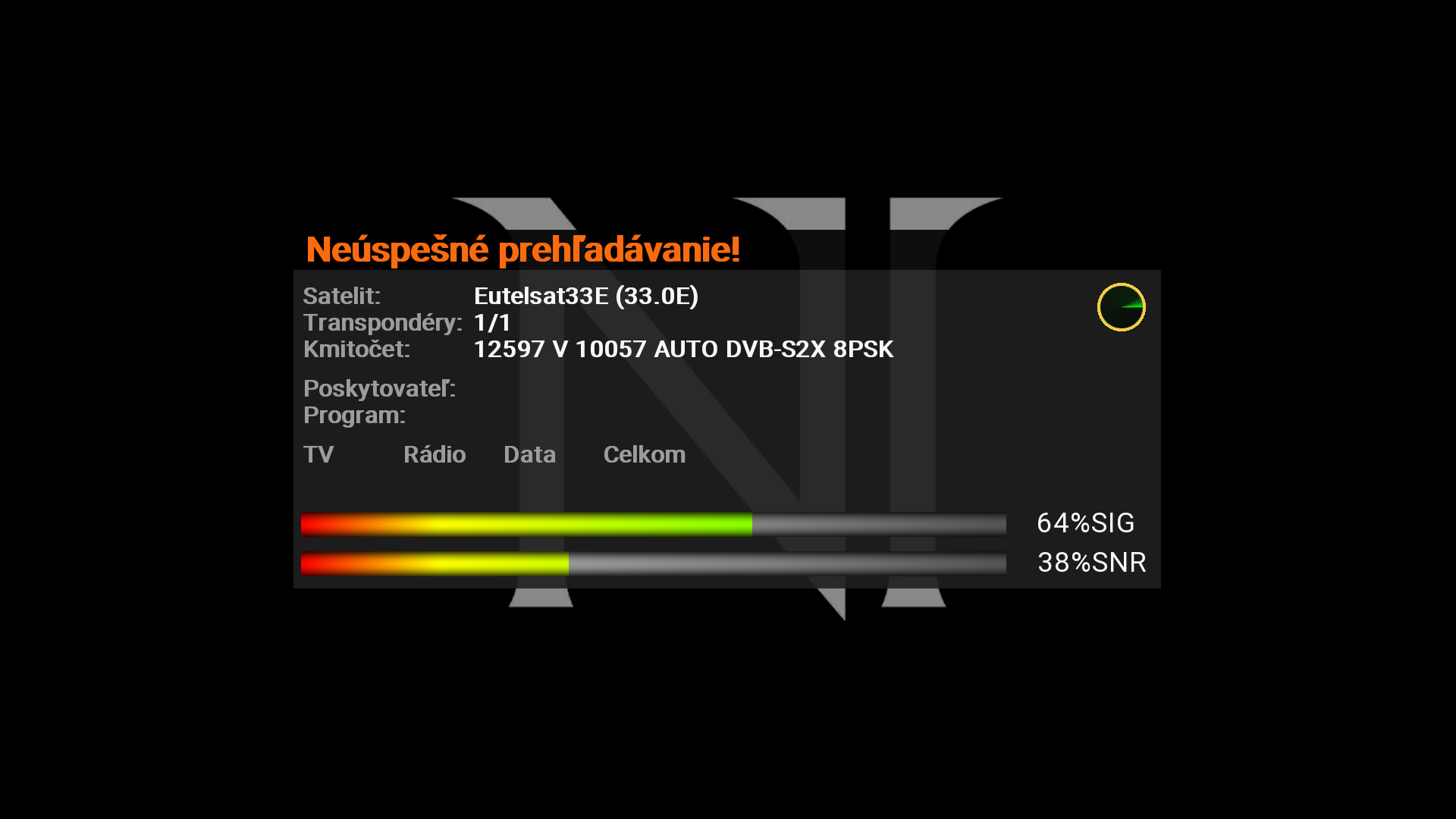

Real DVB-S2X transponder not scan as DVB-S2X
Echter DVB-S2X-Transponder scannt nicht als DVB-S2X must set as DVB-S2
muss als DVB-S2 eingestellt sein for TangoCash

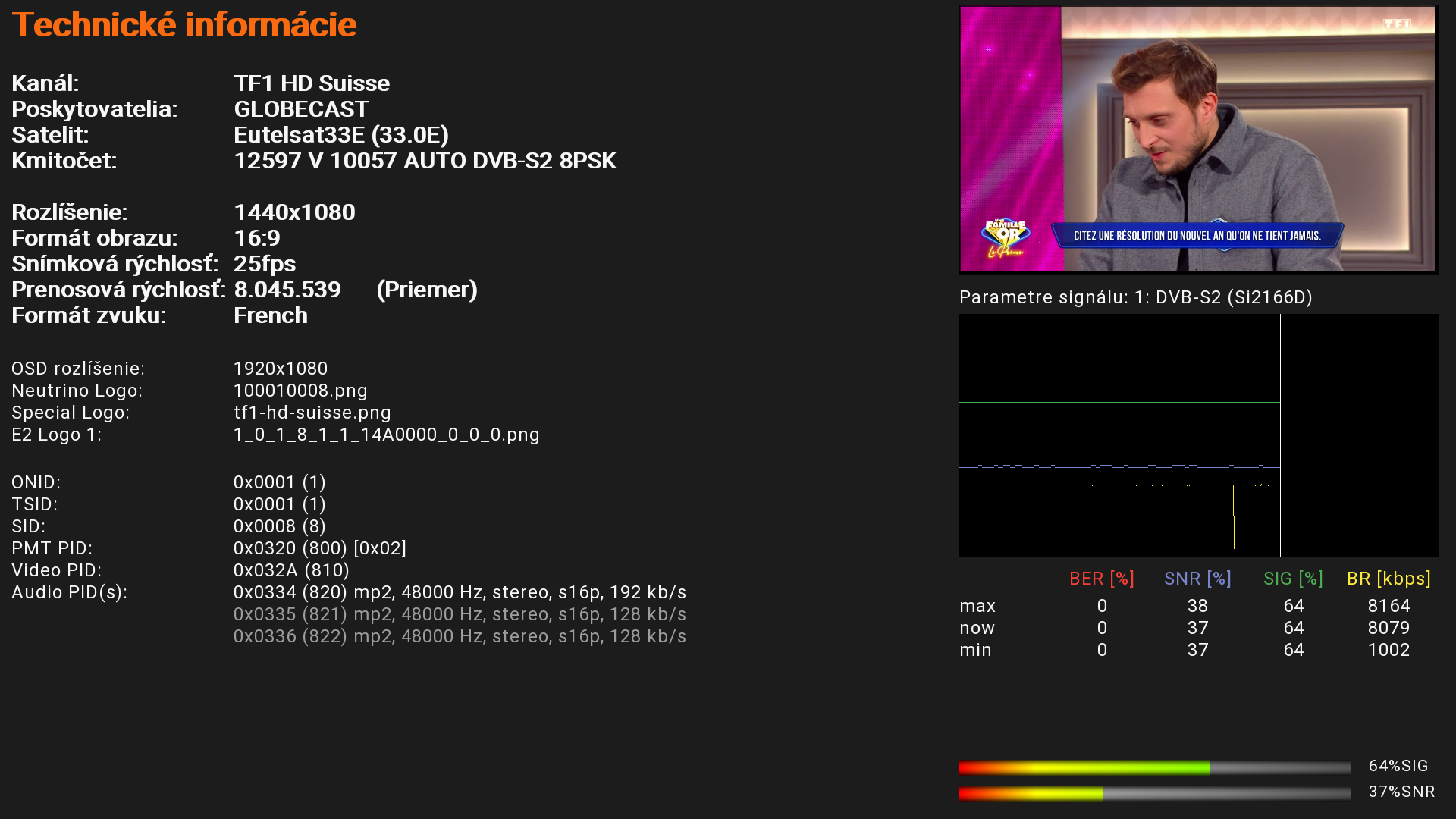

manual scan MIS no problem (problem only translation from XML - DVB-S2 with PLS or MIS show as DVB-S2X)
manueller Scan MIS kein Problem (Problem nur Übersetzung aus XML - DVB-S2 mit PLS oder MIS als DVB-S2X anzeigen)

ShowText 'Automatické prehľadávanie vybraného satelitu'
ShowText 'Ručné prehľadávanie'
ShowText 'Späť'
ShowText 'Satelit Eutelsat33E (33.0E)'
ShowText 'Výber transpondéru'
ShowText 'Systém príjmu DVB-S2'
ShowText 'DVB-S2'
ShowText 'DVB-S2X'
ShowText 'Systém príjmu DVB-S2X'
ShowText 'Kmitočet 12597000'
ShowText 'Symbolová rýchlosť (SR) 10057000'
ShowText 'Modulácia 8PSK'
ShowText 'Korekcia chybovosti (FEC) Auto'
ShowText 'Polarizácia V'
ShowText 'Pilot Auto (HW)'
ShowText 'Physical Layer ID (Stream ID) 0'
ShowText 'PLS kód 0'
ShowText 'PLS mód Gold'
ShowText 'Použiť NIT (Network Information Table) nie'
ShowText 'Len nekódované nie'
ShowText 'Vyhľadať a použiť PIDy (Packet Identifier) áno'
ShowText 'Resetovať čísla kanálov nie'
ShowText 'Test signálu'
ShowText 'Spustiť prehľadávanie'
[neutrino] CScanSetup::exec: smanual
[neutrino] CScanSetup::exec scan s in manual mode...
[neutrino] CScanSetup::exec manual...
[neutrino] CScanSetup call saveScanSetup...
[ConfigFile] saving /var/tuxbox/config/scan.conf
[zapit] SetConfig...
[ConfigFile] saving /var/tuxbox/config/zapit/zapit.conf
[femanager.cpp:saveSettings:355] fe0
[femanager.cpp:saveSettings:355] fe1
[ConfigFile] saving /var/tuxbox/config/zapit/frontend.conf
CScanTs::exec manual
StopAutoRecord: autoshift 0
stopPlayBack: stopping...
stopPlayBack: stopped
[zapit.cpp:StopPlayBack:2450] standby 0 playing 1 forced 0 send_pmt 0
[dvb-sub] paused
2022-04-26 23:47:29.743 [sectionsd] Request of stop scanning (now scanning).
[zapit] adding to scan Eutelsat33E (33.0E) (position 330)
[femanager.cpp:getScanFrontend:814] Selected fe: 0
[zapit.cpp:StopPlayBack:2450] standby 0 playing 0 forced 0 send_pmt 1
[capmt.cpp:SetMode:309] channel c61e000100010008 [TF1 HD Suisse] mode 0 STOP src 0 mask 1 -> 0 update 0 rmode 0 mp 0
[capmt.cpp:SetMode:385] (newmask == 0)
[ca_ci] -> SendCAPMT
TP: C61E00010001
SID: 0008
SOURCE: 0
CA_MASK: 0
CALEN: 0
Scrambled: 0
Mode: 0
Enabled: STOP
[scan] scanning sat Eutelsat33E (33.0E) position 330
[scan] NIT no, fta only: no, satellites single
[scan] tp-id 3135014a00010001 freq 12597000 rate 10057000 fec 9 pol 1 mod 9 sys 4096
[scan] add tp from settings: tp-id 3135014a00010001 freq 12597000 rate 10057000 fec 9 pol 1 mod 9 sys 4096
[scan] scanning tp from sat/service
[scan] scanning: tp-id 3135014a00010001 freq 12597000 rate 10057000 fec 9 pol 1 mod 9 sys 4096
[scan] [fe0] does not support delivery system 4096, skipping
[scan] found 1 transponders (1 failed) and 0 channels
[dvb-sub] paused
2022-04-26 23:49:20.312 [sectionsd] Request of stop scanning (now scanning).
key: 018f value 0, translate: 018f -green button-
TP: C61E00010001
SID: 0008
SOURCE: 0
CA_MASK: 0
CALEN: 0
Scrambled: 0
Mode: 0
Enabled: STOP
[scan] tp-id 3135014a00010001 freq 12597000 rate 10057000 fec 9 pol 1 mod 9 sys 2
[scan] add tp from settings: tp-id 3135014a00010001 freq 12597000 rate 10057000 fec 9 pol 1 mod 9 sys 2
[scan] scanning: tp-id 3135014a00010001 freq 12597000 rate 10057000 fec 9 pol 1 mod 9 sys 2
ShowText 'scan: 0/1'
ShowText 'scan 1/1'
2022-04-26 23:49:20.397 [sectionsd] cnThread: eit update filter, ch 0x000100010008, current ver 0xff got events 0 (not active)
[fe0/0] tune to 12597000 DVB-S2 8PSK AUTO V/R srate 10057000 pli -1 plc 0 plm 1 (tuner 1997000 offset 10600000 timeout 4000)
[frontend.cpp:setFrontend:1553] [fe0/0] tuner pilot 2 (feparams 2) streamid (-1/0/1)
[frontend.cpp:getEvent:811] [fe0/0] ******** FE_HAS_LOCK: freq 1997000
[fe0/0] tuning took: 320 msec (min 92 max 893)

[scan] similar tp, old tp-id 3135014a00010001 freq 12597000 rate 10057000 fec 9 pol 1 mod 9 sys 2
[scan] similar tp, new tp-id 3135014a00010001 freq 12597000 rate 10057000 fec 9 pol 1 mod 9 sys 2
[scan] tpid ready: 3135014a00010001
[scan] found 1 transponders (0 failed) and 3 channels

Kann jetzt leider MIS nicht testen, => Motor defekt.
Aber mein Gefühl sagt mir, dass fe_can_multistream nicht causal mit DVB-S2X zusaamenhängt.
( https://github.com/neutrino-images/ni-n ... a75fc91c50 )
Soweit mir bekannt, ist Multistream ein DVB-S2 - Feature!
Was bedeutet, dass auch Receiver mit DVB-S2 Tunern MIS beherrschen müssten, sofern die Treiber das zulassen.
Ich habe bisher mit HD51 und Duo4K immer mit Einstellung DVB-S2 die hier verfügbaren MIS-Transponder scannen können. Mit DVB-S2X ging das nicht ! Daher habe ich die "Automatik" damals aus meinem Branch entfernt.
Alles sys="1" !
Dass zur Zeit anscheinend nur DVB-S2X Tuner MIS können, liegt mE nicht an S2X, sondern an der Firmware der Boxen die S2X beherrschen. (aktuellere Treiber, höhere DVB-API Version ?)
Das Treiber-Hickhack bei der Duo4K hing ja ursprünglich auch irgendwie mit dem MIS-Feature zusammen.
Vielleicht sollte man auch can_S2X und has_S2X (ohne expliziten Box-Bezug) zur Verbesserung der Programmlogik einbauen/auswerten.
Ich werde allerdings die nächsten Wochen wahrscheinlich nicht zum Reparieren der Motorschüssel kommen...
Ich kann leider auch nicht gegentesten, was Enigma da veranstaltet.
Trotzdem glaube ich, dass man sich bei der Zuweisung von Features an eine DS-Version an die Definitionen des DVB-Konsortiums halten sollte.

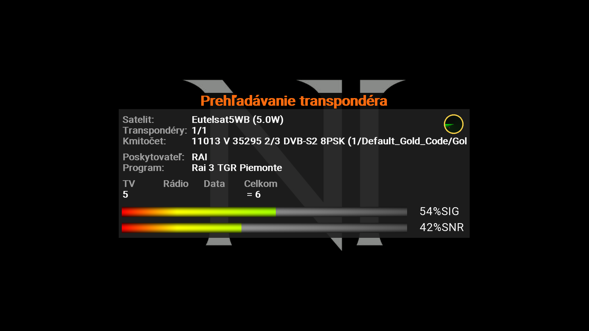

[scan] scanning sat Eutelsat5WB (5.0W) position -50
[scan] tp-id 2b08f03200010001 freq 11016000 rate 35295000 fec 7 pol 0 mod 9 pli 1 plc 131070 plm 1 sys 2
[scan] add tp from settings: tp-id 2b08f03200010001 freq 11016000 rate 35295000 fec 7 pol 0 mod 9 pli 1 plc 131070 plm 1 sys 2
[scan] scanning: tp-id 2b08f03200010001 freq 11016000 rate 35295000 fec 7 pol 0 mod 9 pli 1 plc 131070 plm 1 sys 2
[fe0/0] tune to 11016000 DVB-S2 8PSK 7/8 H/L srate 35295000 pli 1 plc 131070 plm 1 (tuner 1266000 offset 9750000 timeout 4000)
[frontend.cpp:setFrontend:1540] [fe0/0] tuner pilot 2 (feparams 2) streamid (1/131070/1)
ShowText 'scan 1/1'
[frontend.cpp:getEvent:804] [fe0/0] ******** FE_HAS_LOCK: freq 1266000
[fe0/0] tuning took: 136 msec (min 136 max 169)
but 16APSK or 32APSK displays modulation as unknown
[scan_setup.cpp:exec:2107] sat: Eutelsat5WB (5.0W)
[frontend] unknown DVB-S2 modulation 10!
[frontend] unknown DVB-S2 modulation 11!

Der 13E/11355.08V testet nun bis zum 3. Juni einen DVB-S2X/16APSK-Transponder. Aber nur DATEN
The 13E/11355.08V is now testing a DVB-S2X/16APSK transponder until June 3. But only DATA
Auf der Seite schreibe ich über Roll-Off - 5% und CCM, aber die Karte zeigt mir Roll-Off - 20% und VCM/ACM
On the page I write about Roll-Off - 5% and CCM, but the card shows me Roll-Off - 20% and VCM/ACM

Network info - not work
neutrino show - NIT failed , but dvbsnoop show ok NIT

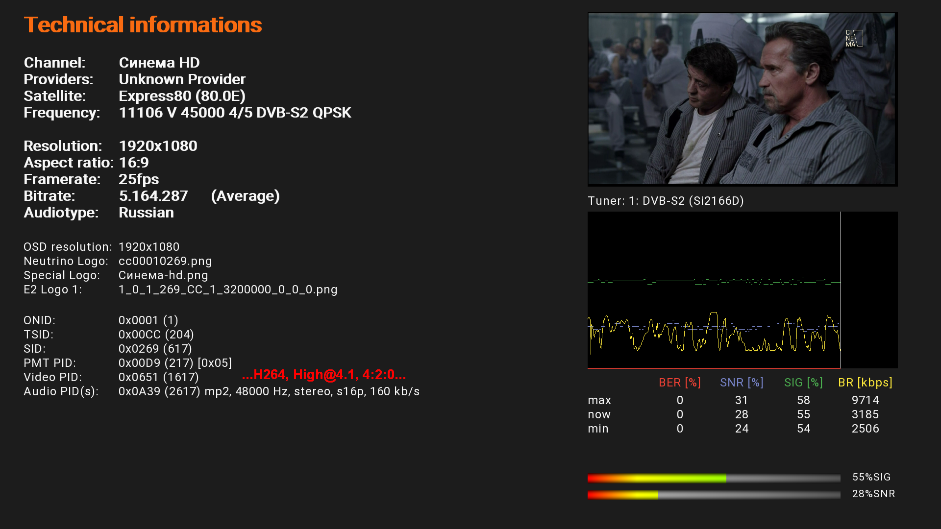

It would also be possible to add video information, similar to how audio information is displayed
Es wäre auch möglich, Bildinformationen hinzuzufügen, ähnlich wie Audioinformationen angezeigt werden
