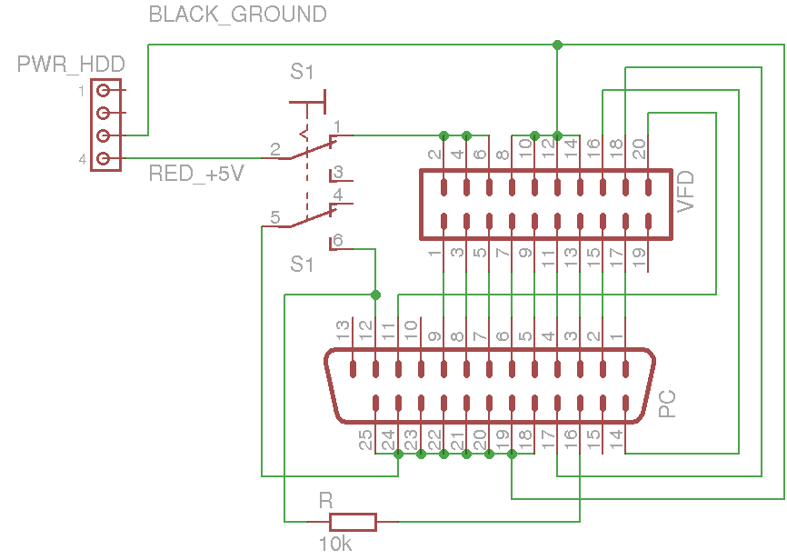

This driver was written based on the manual of the Futaba VFD Module M402SD06GJ to operate on the parallel port. It has been tested with the Futaba VFD M402SD06GL.
Since the display is quiet bright and takes some watts, the wiring contains a double throw switch to switch the VFD on/off. The power state is checked every 100ms by an interal timer.
2. Wiring
This driver requires the following hardwiring.
#!html <h2 style="text-align: left; color: red"> WITHOUT ANY WARRANTY AND AT YOUR OWN RISK <br><br> </h2>
Parallel port
| Pin | 13 | 12 | 11 | 10 | 9 | 8 | 7 | 6 | 5 | 4 | 3 | 2 | 1 |
| Signal | SELECT | PAPEROUT | BUSY* | ACK | D7 | D6 | D5 | D4 | D3 | D2 | D1 | D0 | STROBE* |
| Pin | 25 | 24 | 23 | 22 | 21 | 20 | 19 | 18 | 17 | 16 | 15 | 14 | |
| Signal | GND | SLCTIN* | INIT | ERROR | AUTOFD* | ||||||||
| * inverted | |||||||||||||
VFD connector
| Pin | 2 | 4 | 6 | 8 | 10 | 12 | 14 | 16 | 18 | 20 |
| Signal | +5V | GND | TEST | SEL* | BUSY | |||||
| Pin | 1 | 3 | 5 | 7 | 9 | 11 | 13 | 15 | 17 | 19 |
| Signal | D7 | D6 | D5 | D4 | D3 | D2 | D1 | D0 | WR* | — |
| *inverted | ||||||||||
