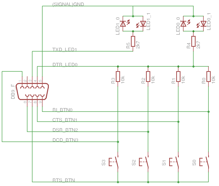

===== 2.1. Wiring
The program requires the following wiring. Two antiparrallel LEDs may be replaced be a 2-Pin-Duo-LED or one of them by a normal diode.
