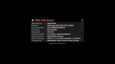

So, ich habe jetzt mal zum Test eine Samsung SSD in eine Neo2 eingebaut und dort formatiert, läuft problemlos.
Angezeigt wird sie so:

mach doch mal wie der TE nachm Booten dmesg im Telnet, so zum Vergleich...

So, hier das Log
     ##    ##  ##      http://www.neutrino-images.de
Kernel: 2.6.34.13-nevis #1 Sat Jun 24 19:32:15 CEST 2017 @armv6l
Date: Sunday, 09 December 2018, 08:38:06
NI-FLASH-0035AE login: root
Password:
[NI-FLASH-0035AE] /var/root # dmesg
Linux version 2.6.34.13-nevis (gandharva@ghibli) (gcc version 4.9.4 (crosstool-NG crosstool-ng-1.23.0-36-g1dbb06f2) ) #1 Sat Jun 24 19:32:15 CEST 2017

o = unutilized or Kernel RAM
KAL: Starting the KAL...
KAL ioremap of Bank[0] uncached memory from 0x86800000 to 0x9c000000
KAL ioremap of Bank[1] uncached memory from 0x92700000 to 0xa2000000
KAL Bank[0] cached    @ V:0x81000000 == P:0x01000000, 2048 KB
KAL Bank[0] uncached  @ V:0x86800000 == P:0x06800000, 97280 KB
KAL Bank[0] content   @ V:0x81400000 == P:0x01400000, 86016 KB
KAL Bank[1] cached    @ V:0x00000000 == P:0x00000000, 0 KB
KAL Bank[1] uncached  @ V:0x92700000 == P:0x12700000, 20480 KB
KAL Bank[1] content   @ V:0x90000000 == P:0x10000000, 39936 KB
KAL: Tiled physical region 0x01400000 to 0x06680000 (15)
KAL: Tiled physical region 0x10000000 to 0x12580000 (15)
KAL: Module loaded
cnxt_base_drv: KAL Started
cnxt_base_drv: Initializing Edwards drivers...
cnxt_base_drv: Done initializing Edwards drivers.
cnxt_base_drv: Module loaded with major device 101
FB: cnxtfb_init_inst, plane OSD
FB: mode 1280x720p-50
FB: HD Mode: 1280x720 FrameRate 5
SD Mode: 720x576 FrameRate 2
/proc/cnxt_trace_flags created
 # alsa_card_CX2450_init Success  8 , 116
cs_control: module init
cs_tsx_hsdp_set_port_speed: num: 594 denom: 7
CX2450x I2C-bus driver version 0.3b (Oct  8 2013, 14:34:47) (c) Coolstream International Limited
cnxt_sata version 2.3cs
scsi0 : cnxt_sata
ata1: SATA max UDMA/133 irq 42
scsi1 : cnxt_sata
ata2: SATA max UDMA/133 irq 35
ata1: SATA link down (SStatus 0 SControl 300)
ata2: SATA link up 3.0 Gbps (SStatus 123 SControl 300)
ata2.00: supports DRM functions and may not be fully accessable.
ata2.00: ATA-11: Samsung SSD 860 EVO 250GB, RVT01B6Q, max UDMA/133
ata2.00: 488397168 sectors, multi 1: LBA48 NCQ (depth 0/32)
ata2.00: configured for UDMA/133
scsi 1:0:0:0: Direct-Access     ATA      Samsung SSD 860  RVT0 PQ: 0 ANSI: 5
sd 1:0:0:0: [sda] 488397168 512-byte logical blocks: (250 GB/232 GiB)
sd 1:0:0:0: [sda] Write Protect is off
sd 1:0:0:0: [sda] Mode Sense: 00 3a 00 00
sd 1:0:0:0: [sda] Write cache: enabled, read cache: enabled, doesn't support DPO or FUA
 sda: sda1
sd 1:0:0:0: Attached scsi generic sg0 type 0
sd 1:0:0:0: [sda] Attached SCSI disk
usbcore: registered new interface driver r871x_usb_drv
rtw driver version=v3.4.3_4369.20120622
Build at: Dec  5 2012 15:05:54
usbcore: registered new interface driver rtl8192cu
rt2870sta: module is from the staging directory, the quality is unknown, you have been warned.
rtusb init --->
usbcore: registered new interface driver rt2870
EXT4-fs (sda1): recovery complete
EXT4-fs (sda1): mounted filesystem with ordered data mode
vmac_mii_bus: probed
arcvmac arcvmac: PHY driver [Generic PHY] (mii_bus:phy_addr=0:09, irq=-1)
Slow work thread pool: Starting up
Slow work thread pool: Ready
fuse init (API version 7.13)
usbcore: registered new interface driver usbserial
usbserial: USB Serial Driver core
USB Serial support registered for FTDI USB Serial Device
usbcore: registered new interface driver ftdi_sio
ftdi_sio: v1.5.0:USB FTDI Serial Converters Driver
tun: Universal TUN/TAP device driver, 1.6
tun: (C) 1999-2004 Max Krasnyansky <maxk@qualcomm.com>
USB Serial support registered for pl2303
usbcore: registered new interface driver pl2303
pl2303: Prolific PL2303 USB to serial adaptor driver
PHY: 0:09 - Link is Down
cs_frontend version 0.6b
DVB: registering new adapter (cs_frontend_dvb)
stv090x_attach: Trying to attach STV090x demodulator(1)
DVB: Unable to find symbol cx24116_attach()
DVB: registering adapter 0 frontend 0 (NXP OM3917 (TDA10025+TDA18260))...
DVB: registering adapter 0 frontend 1 (NXP OM3917 (TDA10025+TDA18260))...
PHY: 0:09 - Link is Up - 100/Full
dtv_property_dump: tvp.cmd = 0x0000002c undefined
cs_tsx_hsdp_set_port_speed: num: 66 denom: 1
