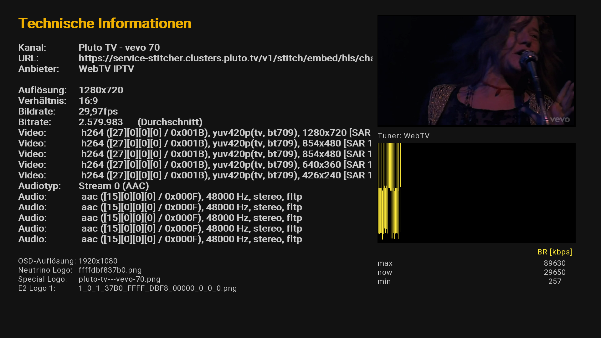

nachtrag .. hinweis ..
pluto.tv hat bei den vevo streams die max. auflösung geändert von 1920x1080 in 1280x720

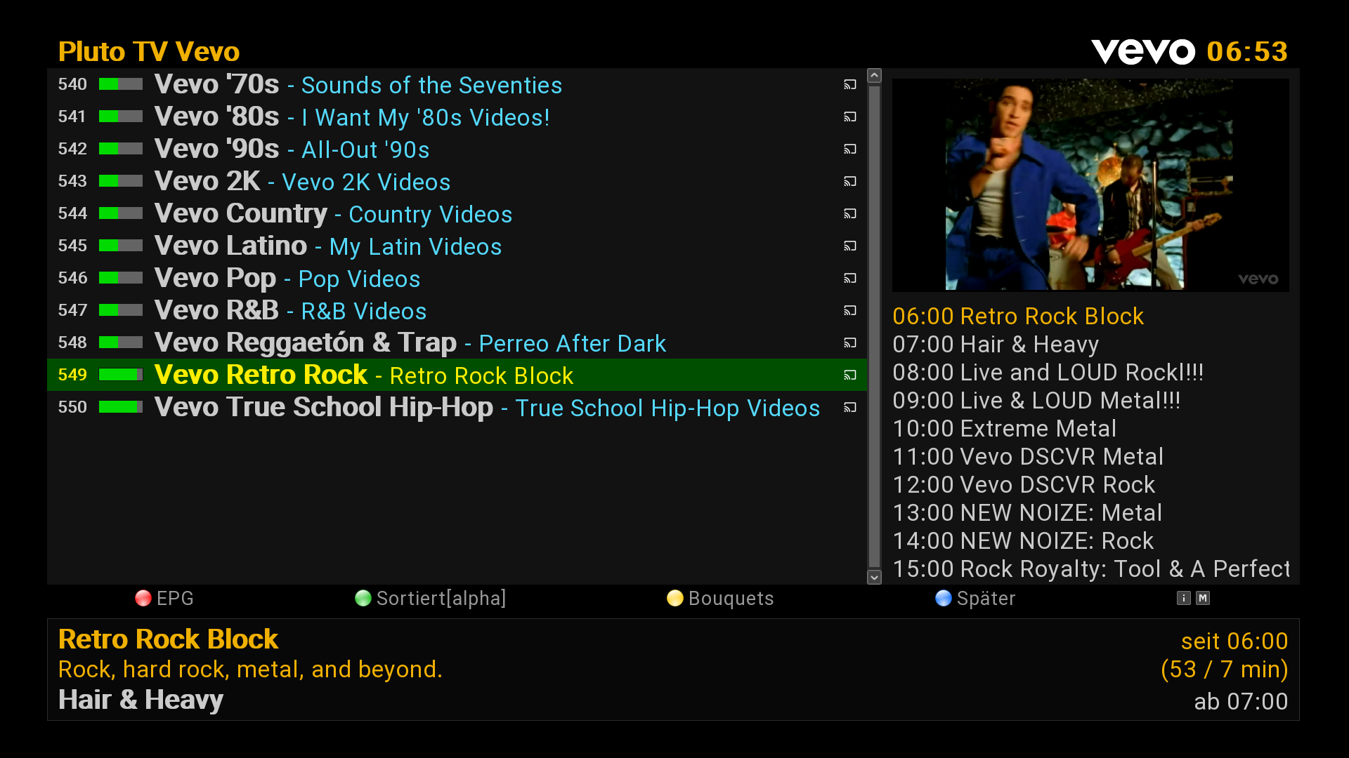

Wer noch ein paar alternative Streamadressen braucht ....
<webtv title="Pluto TV VEVO 2K (1080p)" url="https://service-stitcher.clusters.pluto.tv/v1/stitch/embed/hls/channel/5fd7bca3e0a4ee0007a38e8c/master.m3u8?deviceId=channel&amp;deviceModel=web&amp;deviceVersion=1.0&amp;appVersion=1.0&amp;deviceType=rokuChannel&amp;deviceMake=rokuChannel&amp;deviceDNT=1&amp;advertisingId=channel&amp;embedPartner=rokuChannel&amp;appName=rokuchannel&amp;is_lat=1&amp;bmodel=bm1&amp;content=channel&amp;platform=web&amp;tags=ROKU_CONTENT_TAGS&amp;coppa=false&amp;content_type=livefeed&amp;rdid=channel&amp;genre=ROKU_ADS_CONTENT_GENRE&amp;content_rating=ROKU_ADS_CONTENT_RATING&amp;studio_id=viacom&amp;channel_id=channel" epgid="" genre="Movie" description="webtv" />
    <webtv title="Pluto TV VEVO 2K (1080p) [Not 24/7]" url="https://service-stitcher.clusters.pluto.tv/v1/stitch/embed/hls/channel/5fd7bca3e0a4ee0007a38e8c/master.m3u8?advertisingId=channel&amp;appName=rokuchannel&amp;appVersion=1.0&amp;bmodel=bm1&amp;channel_id=channel&amp;content=channel&amp;content_rating=ROKU_ADS_CONTENT_RATING&amp;content_type=livefeed&amp;coppa=false&amp;deviceDNT=1&amp;deviceId=channel&amp;deviceMake=rokuChannel&amp;deviceModel=web&amp;deviceType=rokuChannel&amp;deviceVersion=1.0&amp;embedPartner=rokuChannel&amp;genre=ROKU_ADS_CONTENT_GENRE&amp;is_lat=1&amp;platform=web&amp;rdid=channel&amp;studio_id=viacom&amp;tags=ROKU_CONTENT_TAGS" epgid="" genre="Movie" description="webtv" />
    <webtv title="Pluto TV VEVO 70's (1080p)" url="https://service-stitcher.clusters.pluto.tv/v1/stitch/embed/hls/channel/5f32f26bcd8aea00071240e5/master.m3u8?advertisingId=channel&amp;appName=rokuchannel&amp;appVersion=1.0&amp;bmodel=bm1&amp;channel_id=channel&amp;content=channel&amp;content_rating=ROKU_ADS_CONTENT_RATING&amp;content_type=livefeed&amp;coppa=false&amp;deviceDNT=1&amp;deviceId=channel&amp;deviceMake=rokuChannel&amp;deviceModel=web&amp;deviceType=rokuChannel&amp;deviceVersion=1.0&amp;embedPartner=rokuChannel&amp;genre=ROKU_ADS_CONTENT_GENRE&amp;is_lat=1&amp;platform=web&amp;rdid=channel&amp;studio_id=viacom&amp;tags=ROKU_CONTENT_TAGS" epgid="" genre="Movie" description="webtv" />
    <webtv title="Pluto TV VEVO 80's (1080p)" url="https://service-stitcher.clusters.pluto.tv/v1/stitch/embed/hls/channel/5fd7b8bf927e090007685853/master.m3u8?advertisingId=channel&amp;appName=rokuchannel&amp;appVersion=1.0&amp;bmodel=bm1&amp;channel_id=channel&amp;content=channel&amp;content_rating=ROKU_ADS_CONTENT_RATING&amp;content_type=livefeed&amp;coppa=false&amp;deviceDNT=1&amp;deviceId=channel&amp;deviceMake=rokuChannel&amp;deviceModel=web&amp;deviceType=rokuChannel&amp;deviceVersion=1.0&amp;embedPartner=rokuChannel&amp;genre=ROKU_ADS_CONTENT_GENRE&amp;is_lat=1&amp;platform=web&amp;rdid=channel&amp;studio_id=viacom&amp;tags=ROKU_CONTENT_TAGS" epgid="" genre="Movie" description="webtv" />
    <webtv title="Pluto TV VEVO 90's (1080p)" url="https://service-stitcher.clusters.pluto.tv/v1/stitch/embed/hls/channel/5fd7bb1f86d94a000796e2c2/master.m3u8?advertisingId=channel&amp;appName=rokuchannel&amp;appVersion=1.0&amp;bmodel=bm1&amp;channel_id=channel&amp;content=channel&amp;content_rating=ROKU_ADS_CONTENT_RATING&amp;content_type=livefeed&amp;coppa=false&amp;deviceDNT=1&amp;deviceId=channel&amp;deviceMake=rokuChannel&amp;deviceModel=web&amp;deviceType=rokuChannel&amp;deviceVersion=1.0&amp;embedPartner=rokuChannel&amp;genre=ROKU_ADS_CONTENT_GENRE&amp;is_lat=1&amp;platform=web&amp;rdid=channel&amp;studio_id=viacom&amp;tags=ROKU_CONTENT_TAGS" epgid="" genre="Movie" description="webtv" />
    <webtv title="Pluto TV VEVO Country (1080p)" url="https://service-stitcher.clusters.pluto.tv/v1/stitch/embed/hls/channel/5da0d75e84830900098a1ea0/master.m3u8?advertisingId=channel&amp;appName=rokuchannel&amp;appVersion=1.0&amp;bmodel=bm1&amp;channel_id=channel&amp;content=channel&amp;content_rating=ROKU_ADS_CONTENT_RATING&amp;content_type=livefeed&amp;coppa=false&amp;deviceDNT=1&amp;deviceId=channel&amp;deviceMake=rokuChannel&amp;deviceModel=web&amp;deviceType=rokuChannel&amp;deviceVersion=1.0&amp;embedPartner=rokuChannel&amp;genre=ROKU_ADS_CONTENT_GENRE&amp;is_lat=1&amp;platform=web&amp;rdid=channel&amp;studio_id=viacom&amp;tags=ROKU_CONTENT_TAGS" epgid="" genre="Movie" description="webtv" />
    <webtv title="Pluto TV VEVO R&amp;B (1080p)" url="https://service-stitcher.clusters.pluto.tv/v1/stitch/embed/hls/channel/5da0d83f66c9700009b96d0e/master.m3u8?advertisingId=channel&amp;appName=rokuchannel&amp;appVersion=1.0&amp;bmodel=bm1&amp;channel_id=channel&amp;content=channel&amp;content_rating=ROKU_ADS_CONTENT_RATING&amp;content_type=livefeed&amp;coppa=false&amp;deviceDNT=1&amp;deviceId=channel&amp;deviceMake=rokuChannel&amp;deviceModel=web&amp;deviceType=rokuChannel&amp;deviceVersion=1.0&amp;embedPartner=rokuChannel&amp;genre=ROKU_ADS_CONTENT_GENRE&amp;is_lat=1&amp;platform=web&amp;rdid=channel&amp;studio_id=viacom&amp;tags=ROKU_CONTENT_TAGS" epgid="" genre="Movie" description="webtv" />
    <webtv title="Pluto TV VEVO Reggeaton &amp; Trap (1080p)" url="https://service-stitcher.clusters.pluto.tv/v1/stitch/embed/hls/channel/5f32f397795b750007706448/master.m3u8?advertisingId=channel&amp;appName=rokuchannel&amp;appVersion=1.0&amp;bmodel=bm1&amp;channel_id=channel&amp;content=channel&amp;content_rating=ROKU_ADS_CONTENT_RATING&amp;content_type=livefeed&amp;coppa=false&amp;deviceDNT=1&amp;deviceId=channel&amp;deviceMake=rokuChannel&amp;deviceModel=web&amp;deviceType=rokuChannel&amp;deviceVersion=1.0&amp;embedPartner=rokuChannel&amp;genre=ROKU_ADS_CONTENT_GENRE&amp;is_lat=1&amp;platform=web&amp;rdid=channel&amp;studio_id=viacom&amp;tags=ROKU_CONTENT_TAGS" epgid="" genre="Movie" description="webtv" />
    <webtv title="Pluto TV VH1 Classics" url="https://service-stitcher.clusters.pluto.tv/v1/stitch/embed/hls/channel/6076cd1df8576d0007c82193/master.m3u8?deviceId=channel&amp;deviceModel=web&amp;deviceVersion=1.0&amp;appVersion=1.0&amp;deviceType=rokuChannel&amp;deviceMake=rokuChannel&amp;deviceDNT=1&amp;advertisingId=channel&amp;embedPartner=rokuChannel&amp;appName=rokuchannel&amp;is_lat=1&amp;bmodel=bm1&amp;content=channel&amp;platform=web&amp;tags=ROKU_CONTENT_TAGS&amp;coppa=false&amp;content_type=livefeed&amp;rdid=channel&amp;genre=ROKU_ADS_CONTENT_GENRE&amp;content_rating=ROKU_ADS_CONTENT_RATING&amp;studio_id=viacom&amp;channel_id=channel" epgid="" genre="Movie" description="webtv" />
    <webtv title="Pluto TV VH1 Classics (720p)" url="https://service-stitcher.clusters.pluto.tv/v1/stitch/embed/hls/channel/6076cd1df8576d0007c82193/master.m3u8?advertisingId=channel&amp;appName=rokuchannel&amp;appVersion=1.0&amp;bmodel=bm1&amp;channel_id=channel&amp;content=channel&amp;content_rating=ROKU_ADS_CONTENT_RATING&amp;content_type=livefeed&amp;coppa=false&amp;deviceDNT=1&amp;deviceId=channel&amp;deviceMake=rokuChannel&amp;deviceModel=web&amp;deviceType=rokuChannel&amp;deviceVersion=1.0&amp;embedPartner=rokuChannel&amp;genre=ROKU_ADS_CONTENT_GENRE&amp;is_lat=1&amp;platform=web&amp;rdid=channel&amp;studio_id=viacom&amp;tags=ROKU_CONTENT_TAGS" epgid="" genre="Movie" description="webtv" />

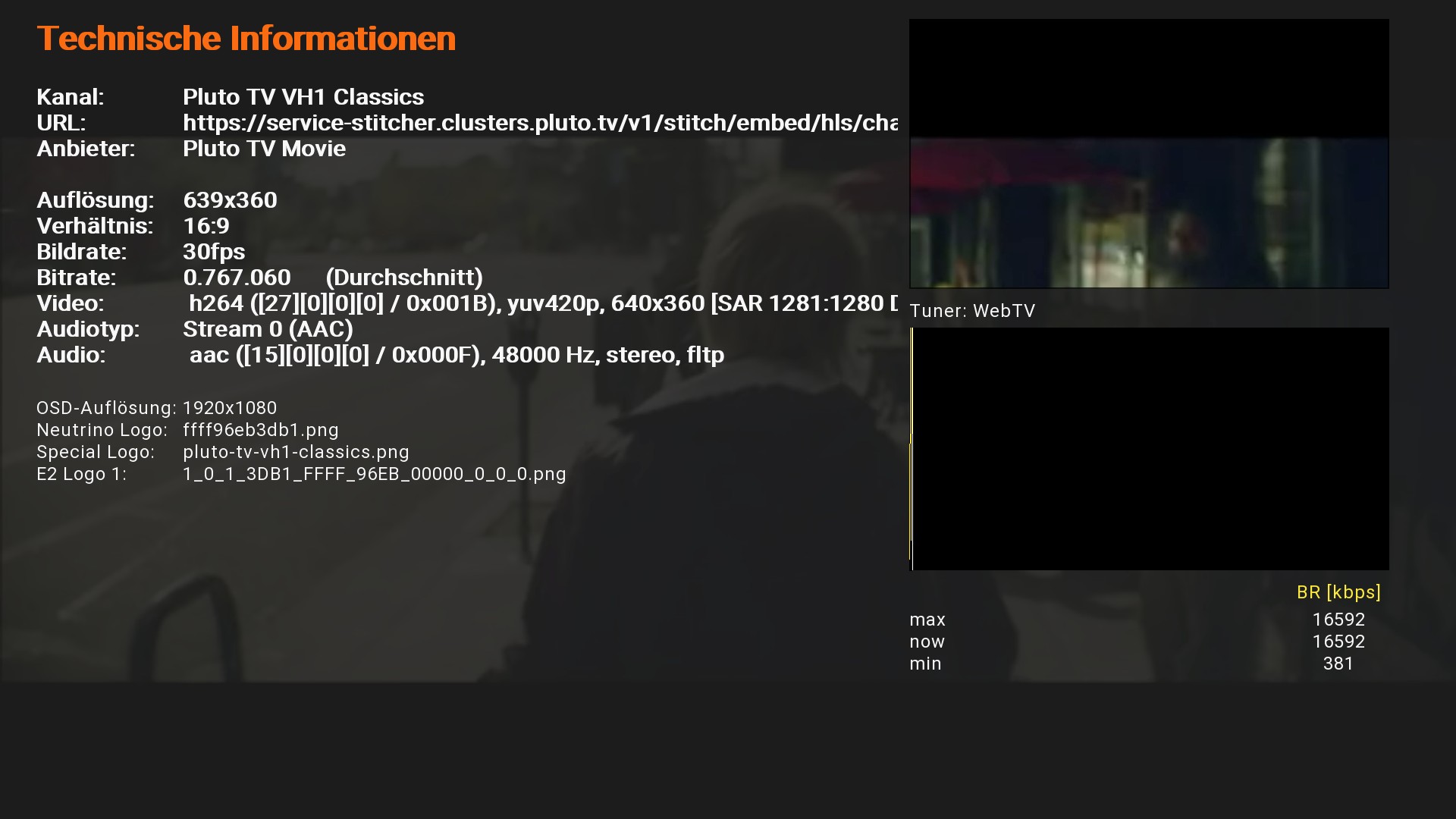

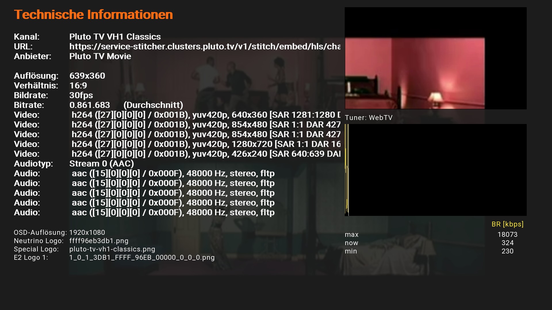

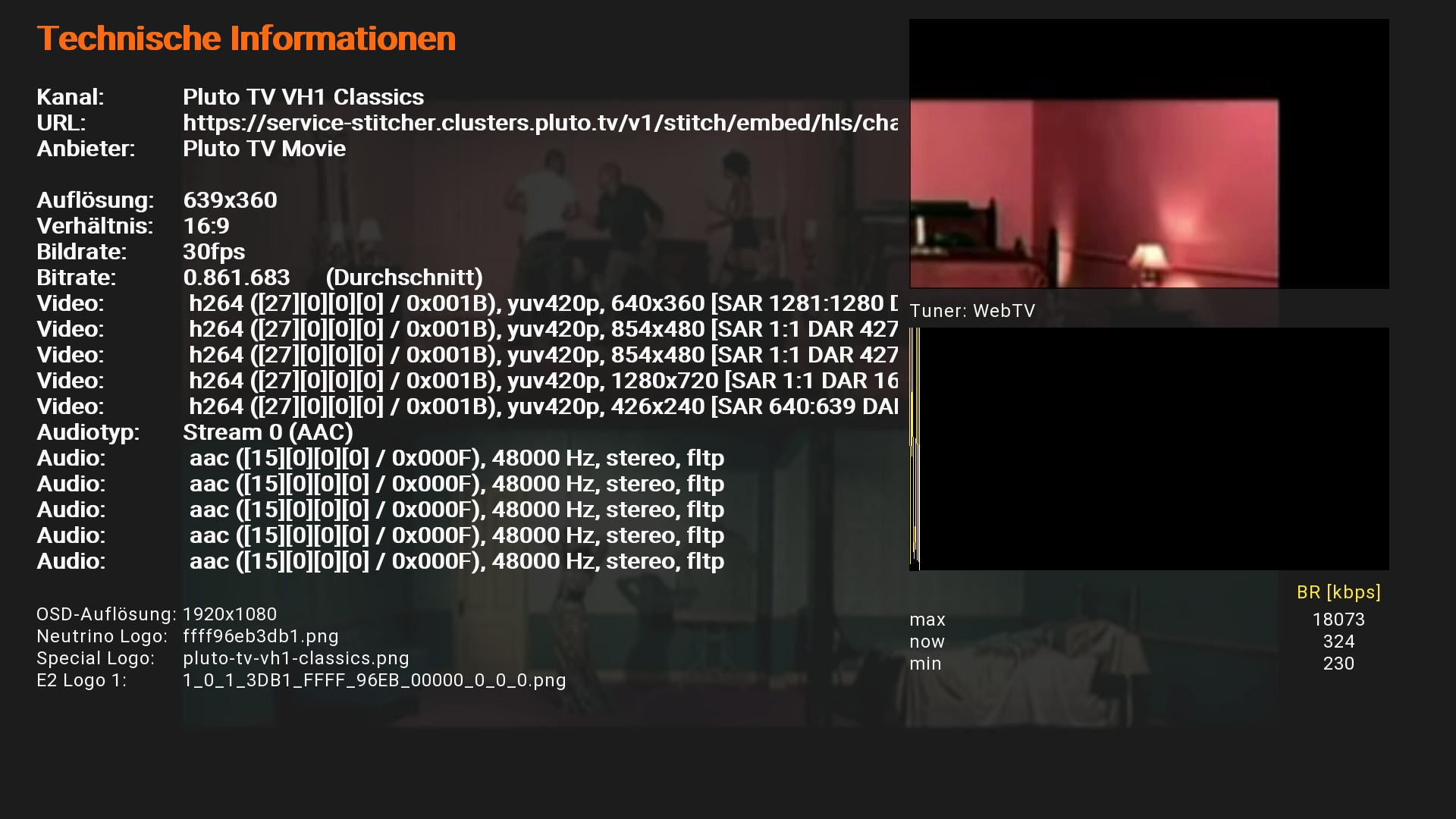

Ich habe eben mal das neue Plugin und die Senderliste von kalle wirsch geladen.
Läuft soweit. Allerdinmgs wird bei den Sendern VH1 Classic nicht die höchste Auflösung genutzt.
Ich habe daraufhin mal probiert das Plugin bestbitrate einzufügen, bringt aber nichts, dann ist es die gleiche Auflösung und die anderen werden nicht mehr aufgeführt.

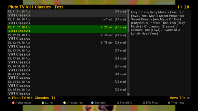

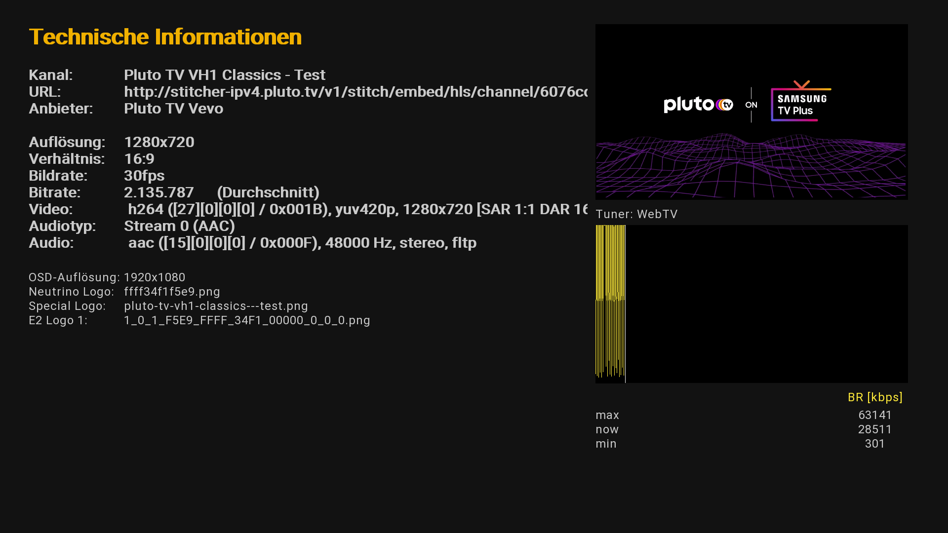

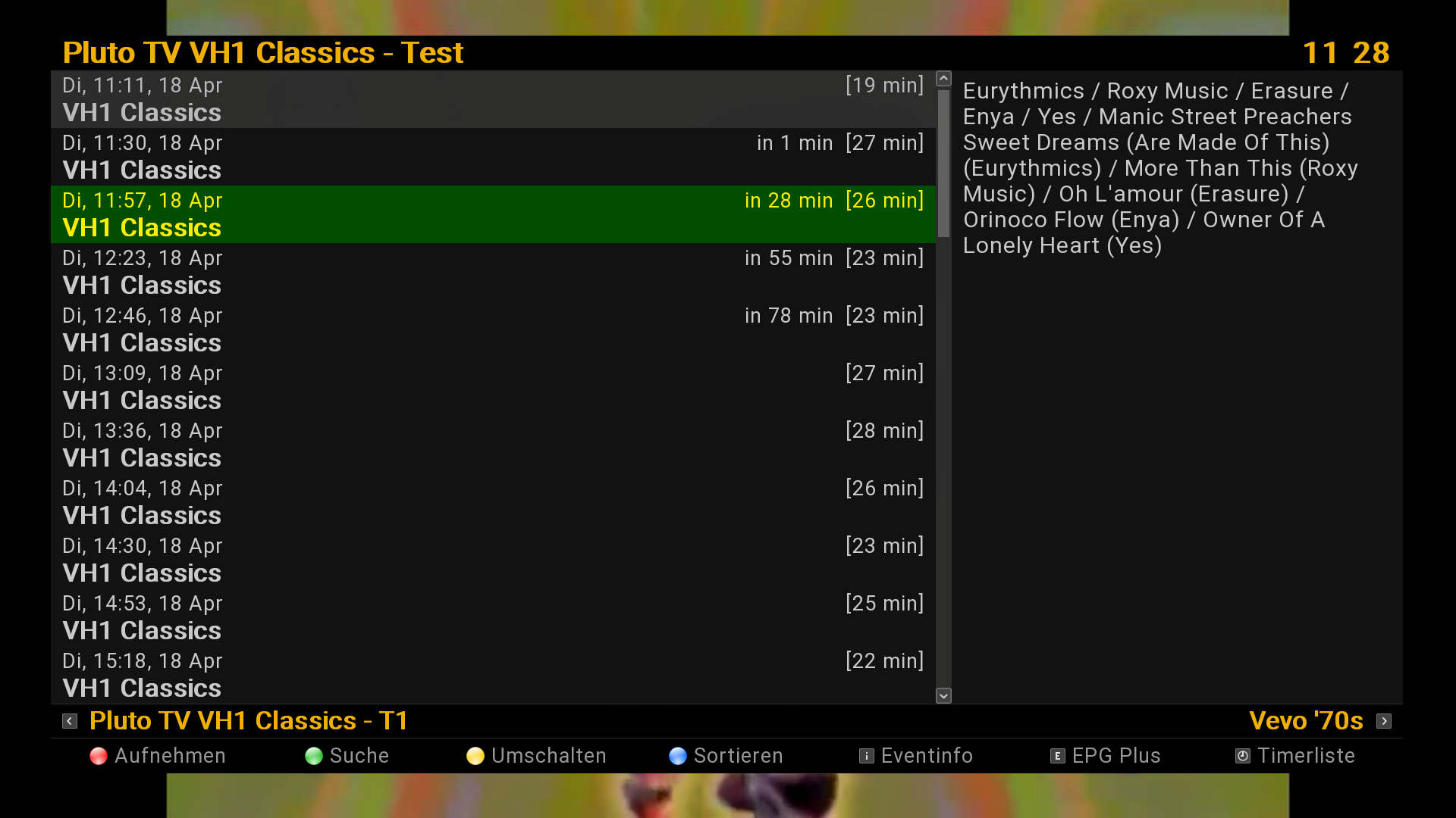

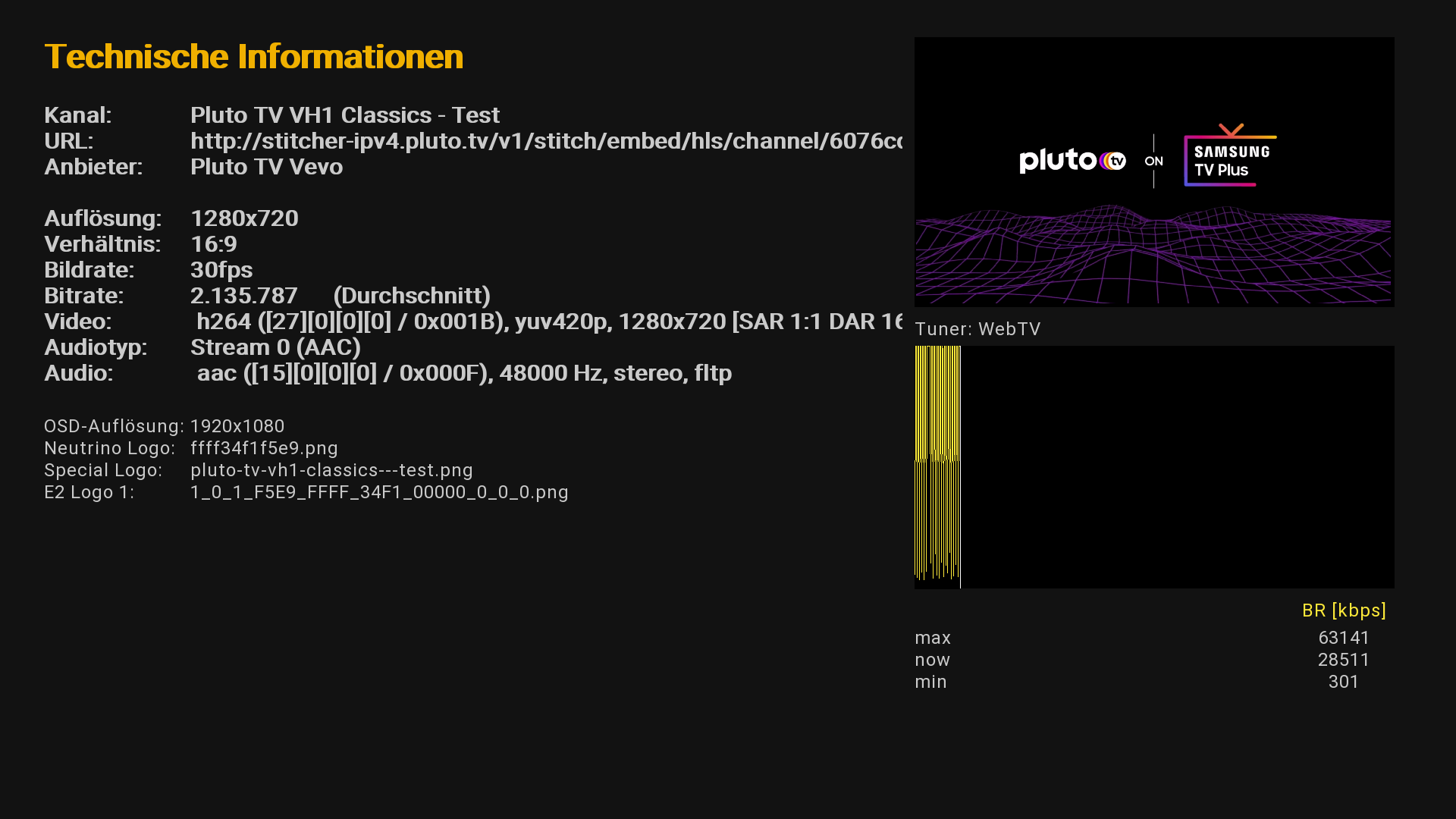

Gorcon hat geschrieben: Mo 17. Apr 2023, 17:42 Ich habe eben mal das neue Plugin und die Senderliste von kalle wirsch geladen.
ich teste grade mit VH1 Classic .. ist ein spanischer sender .. epg ist auch da
xmltv="https://raw.githubusercontent.com/matthuisman/i.mjh.nz/master/PlutoTV/es.xml"
und
epgmap="6076cd1df8576d0007c82193"
und mit einer sid=SAMSUNG-TVPLUS löppt das auch in 720p .. siehe
Beiträge: 3166
Has thanked: 174 times
Re: Pluto TV
jokel hat geschrieben: Di 18. Apr 2023, 11:35
Weil der "nur" eine Auflösung hat.
Wenn da aber mehre Auflösungen geliefert werden würde der Sender unter Umständen das gleiche Problem haben. ;)
Ich wollte ja auch nur darauf hinweisen.
