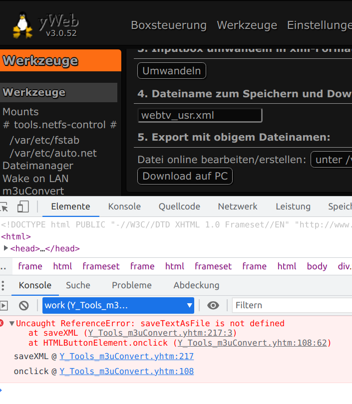

- Beiträge: 391
- Has thanked: 10 times
Aktuell funktioniert im Webif unter mu3Convert nach erfolgter Umwandlung , der Download auf PC nicht mehr ?
Mit älterm Image geht es noch .
Wurde da was verändert ?

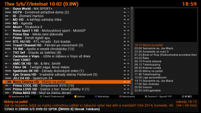

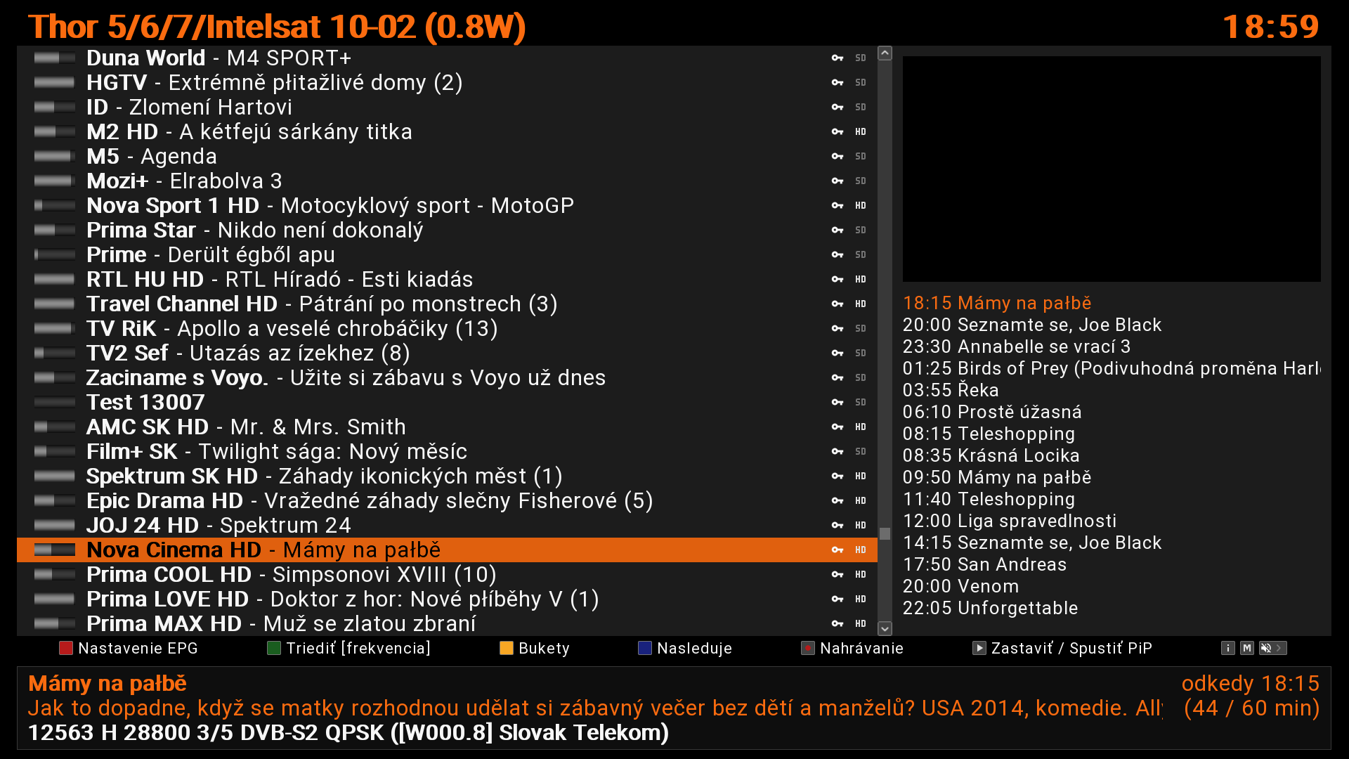

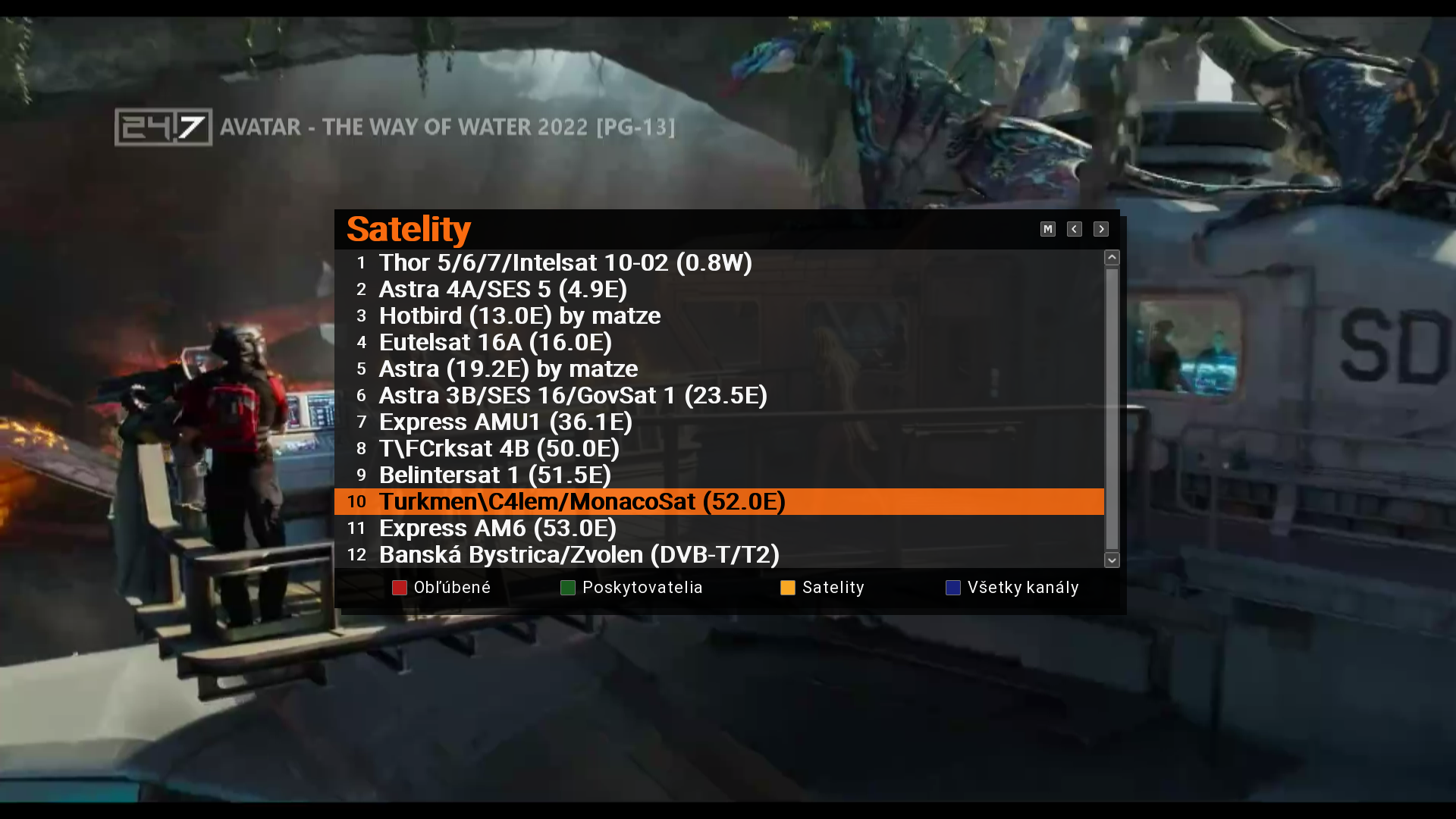

Is it possible to fix the display of satellite names?
Ist es möglich, die Anzeige von Satellitennamen zu korrigieren? Is it possible to fix the EPG?
Kann man das EPG reparieren?
Gibertini OP100L /85E-53W/
- Beiträge: 3161
- Has thanked: 58 times
- Been thanked: 98 times
Yes, it's possible.
Here i need your help. I don't understand the slovak language. Please send a UTF-8 encoded mapping list like this:

Hello,
I think you can change the satellite names in satellites.xml.
You may have to reboot afterwards.
EnoSat
- Beiträge: 55
- Wohnort: Slovakia
- Box: MIO4K+ & HD51 & Solo4K
Yes, but it will overwrite them again after the update. Is it possible that the update does not overwrite mine ?
For example, the XML in enigma2 /etc/tuxbox is overwritten from team and /etc/enigma2 remains/not overwriten (e2 first checks the enigma2 directory and when it finds nothing there, it uses the tuxbox directory)
The solution above needs permanent manual updates from user.
Additional results are a smaller amount and quicker scans: Deleting 'unseen' sat positions and irrelevant transponders (empty, wrong system, local footprints etc)
Look at my satellites.xml. Perhaps it's easier to write a little mapping tool with XSLT and a userdefined lookup "satellitesmap.xml" (this saved within tobackup.conf)
Format like providermap.xml.
Or someone coded this into the source loading satellites.xml...

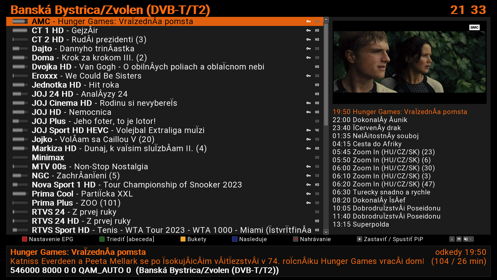

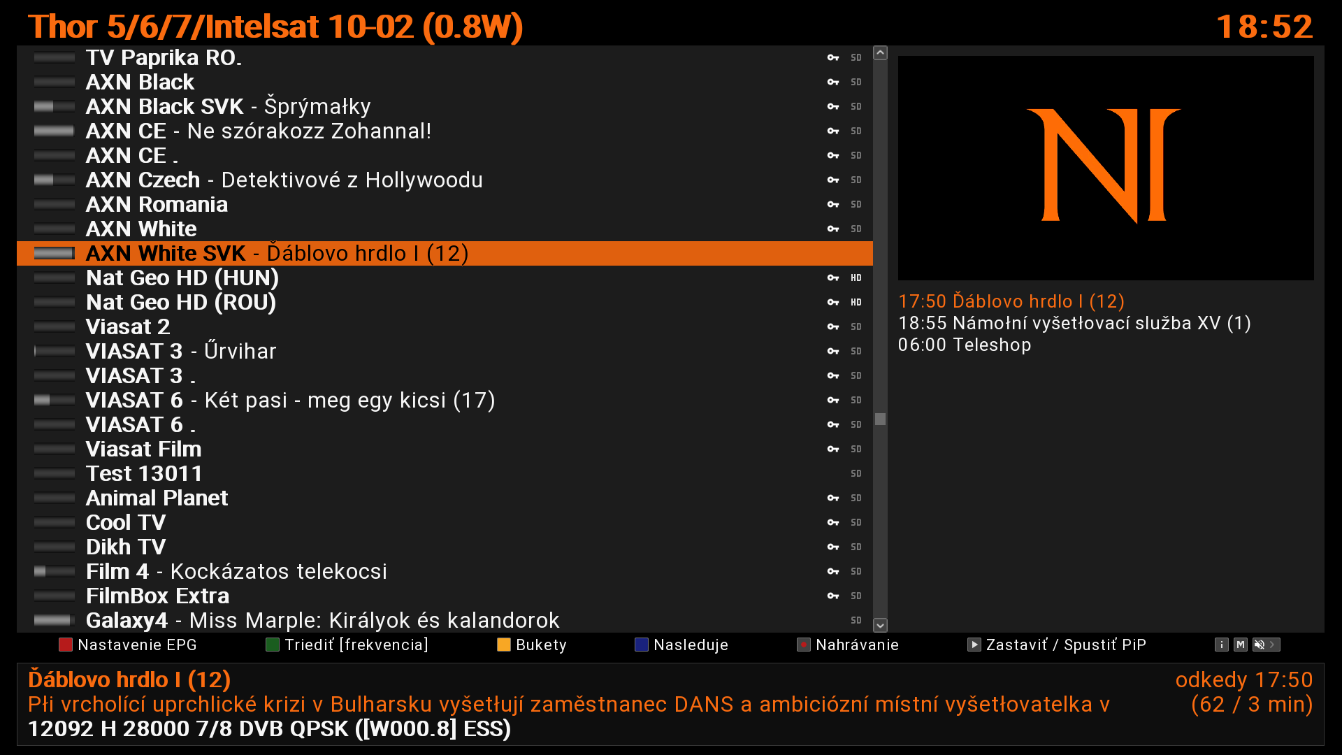

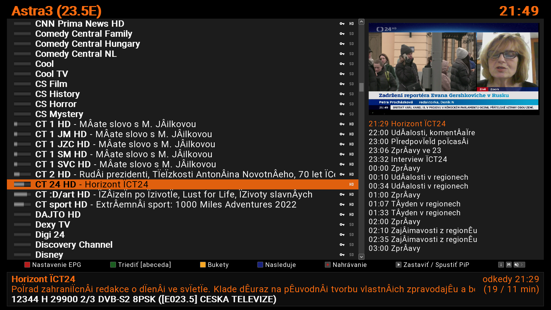

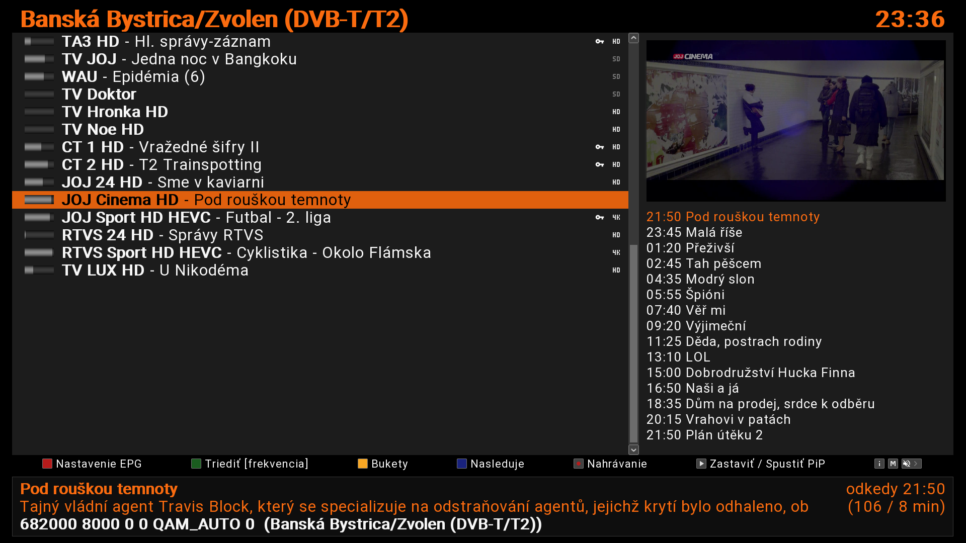

EnoSat
- Beiträge: 55
- Wohnort: Slovakia

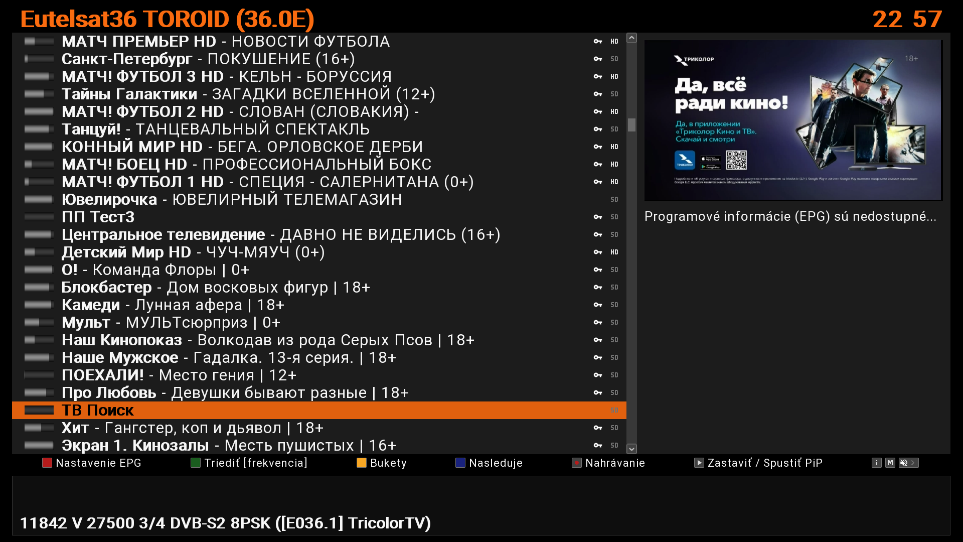

Fixed with encoding.conf (very old in image) but not know why ř show as ł (but Ř displays correctly)vanhofen hat geschrieben: ↑Fr 31. Mär 2023, 06:24 Here i need your help. I don't understand the slovak language. Please send a UTF-8 encoded mapping list like this:Code: Alles auswählen
# from = to  = ɨ
