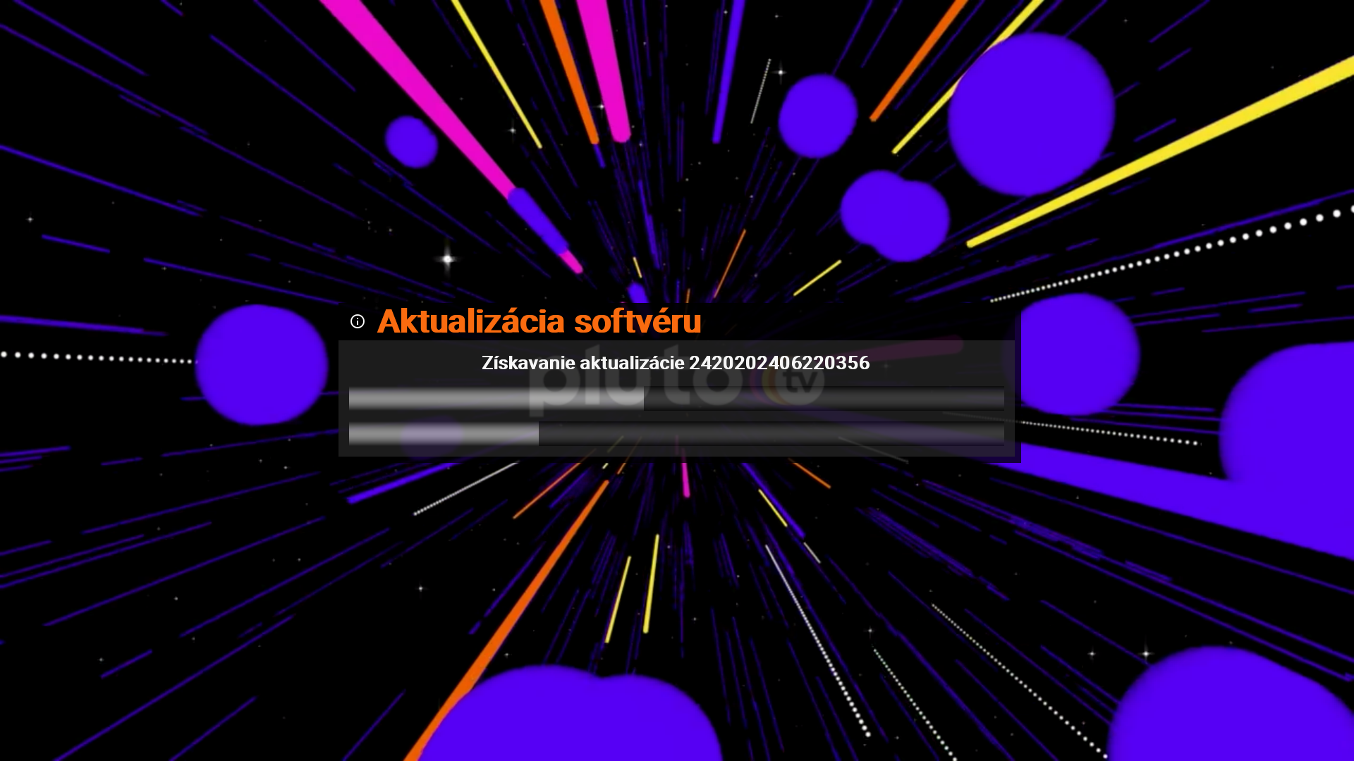

EnoSat
Beiträge: 55
Wohnort: Slovakia
Box: MIO4K+ & HD51 & Solo4K
Re: hd51 mit NI flashen
Beitrag von EnoSat »
Die letzte Online-Abfüllung endet mit dem Fehler NEUTRINO: 137
:cry:
port2.log
(55.5 KiB) 626-mal heruntergeladen

Ein manuelles Update ist kein Problem (ofgwrite -m4 /source_dir)
root@mutant51:~# ofgwrite -m4 /media/hdd/hd51
mkdir: can't create directory '/newroot': File exists
ofgwrite Utility v4.6.2
Author: Betacentauri
Based upon: mtd-utils-native-1.5.1 and busybox 1.24.1
Use at your own risk! Make always a backup before use!
Don't use it if you use multiple ubi volumes in ubi layer!
Flashing multiboot partition 4
Searching image files in /media/hdd/hd51 resolved to /media/hdd/hd51
Found kernel file: /media/hdd/hd51/kernel.bin
Found rootfs file: /media/hdd/hd51/rootfs.tar.bz2
Setting default parameter: Flashing kernel and rootfs
Found EXT4 rootfs
Found mounted /newroot
Found mountpoint for rootfs file: /media/hdd
Found /proc/mtd entries:
Device:   Size:     Erasesize:  Name:                   Image:
Using kernel mtd device:
Using rootfs mtd device:
Read /proc/cmdline
Current rootfs is: /dev/mmcblk0p7
Current kernel is:
Current root sub dir is:
Execute: fdisk -l
Found valid GPT with protective MBR; using GPT
Using /dev/mmcblk0p8 as kernel device
Using /dev/mmcblk0p9 as rootfs device
Flashing currently not running image
Syncing filesystem
Mount rootfs
Mount to /oldroot_remount/ successful
Flashing kernel ...
Successfully flashed kernel!
Flash rootfs unpack
Delete rootfs: rm -r -f /oldroot_remount/
rm: can't remove '/oldroot_remount': Device or resource busy
Untar: tar xf /media/hdd/hd51/rootfs.tar.bz2
Successfully flashed rootfs! Rebooting in 3 seconds...
root@mutant51:~#
aktuelles Image
Image herunterladen
Partitionsauswahl für Flash
das Ergebnis
[neutrino] [update] calling /usr/bin/ofgwrite_caller /tmp /tmp/ni420-202406220356-arm-hd51.tgz -m4
ShowText 'ofgwrite Flashing Tool'
Starting ofgwrite_caller /tmp /tmp/ni420-202406220356-arm-hd51.tgz -m4
Creating tempdir
Unpacking /tmp/ni420-202406220356-arm-hd51.tgz to /tmp/update-HECaMF
kernel.bin
rootfs.tar.bz2
[neutrino] [update] /usr/bin/ofgwrite_caller done
Killed
Jun 22 15:09:49 hd51 user.info start_neutrino[1555]: Neutrino exited with exit code 137
Jun 22 15:09:49 hd51 user.info start_neutrino[1555]: Restarting Neutrino after exit code 137
port3.log
(85.13 KiB) 579-mal heruntergeladen
Gibertini OP100L /85E-53W/
